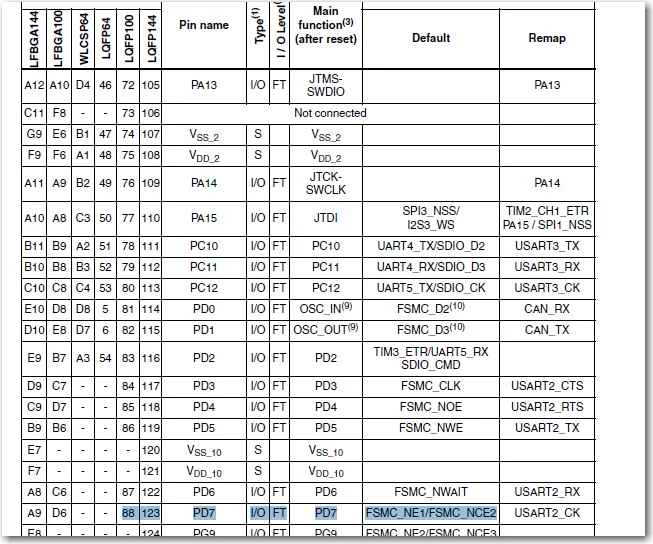

Guys,
How can I multiplex SRAM,NOR Flash and NAND Flash on PD7 ?
It's function as PD7 FSMC_NE1/FSMC_NCE2 on pin 88 for STM32F103VCT6,
is it configurable via software or I need to put a latch / multiplex chip for it ?
Any examples for it (schematic)? What's the common application for NAND flash ?
Can I run my code from NOR Flash ? I saw there's boot option
''System memory is selected as boot space'', page 48 STM32 reference, chapter 2.4 Boot Configuration...
Thanks

You'd probably want to gate it with a high order address bit.
System Memory is the OTP ROM at 0x1FFFFxxx, and which contains the system loader. You'd have to put some start up code in Flash to configure the external bus before you could execute-in-place off the NOR device, and this would run slower on the external bus.

I saw on STM32F103VCT6
Pin 88,  PD7, FSMC_NE1/FSMC_NCE2
and
How can I call PSRAM,NOR flash and NAND flash ?
Will I controll them by software ? How can I control the NE1 Chip Select for two devices SRAM and NOR flash ? any clues ?thanks
