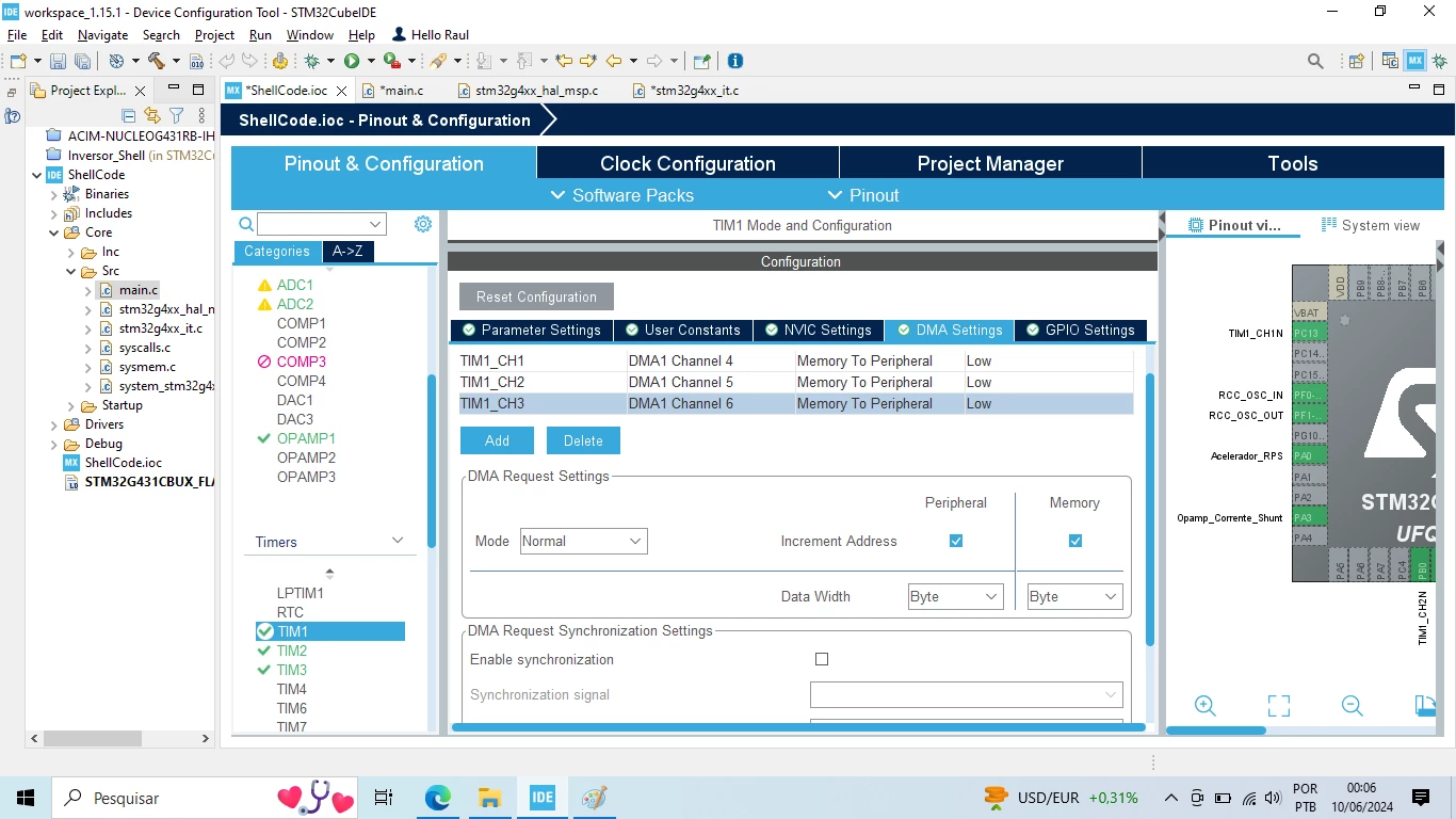

I'm trying to update the duty cycle of 3 channels of timer 1 simultaneously with just one DMA event.

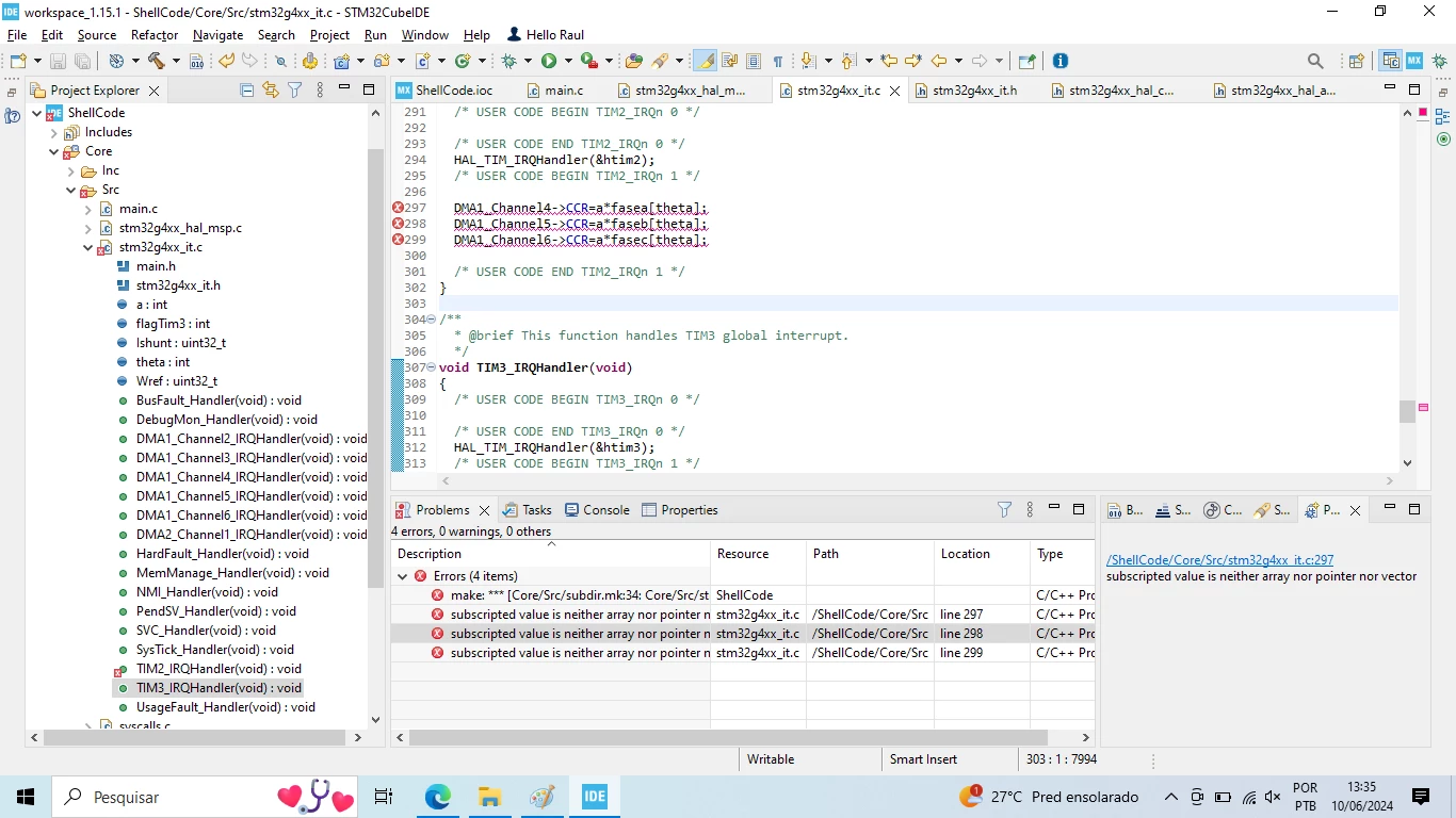

In the TIM2_IRQHandler, your code attempts to directly assign values to the DMA channel's Control Register (CCR):
DMA1_Channel4->CCR = a * fasea[theta];
DMA1_Channel5->CCR = a * faseb[theta];
DMA1_Channel6->CCR = a * fasec[theta];
 This is not the correct way to update the duty cycle of the PWM channels. The CCR of the timer channels should be updated with the duty cycle values, not the DMA channel's CCR. The DMA channel's CCR is used to configure the DMA channel itself, not to transfer data.
Also, the variable "theta" that you're declaring, needs to be a valid index within the bounds of the arrays
I suppose it represents an angle,in this case it needs to stay within the range of 0 to 359, which corresponds to the valid indices for the arrays.
So, theta needs to be properly defined, initialized, and updated somewhere in your code

Hello @RaulPosada, welcome to ST community,
Yes, you can use the DMA burst mode to update multiple Capture/Compare Registers (CCRs) of a single timer simultaneously with one DMA request, which is triggered by the timer's update event.
If you need more details on burst mode, you can refer to the Timer cookbook AN4776
Otherwise, can you be more specific about your question? what's working and what's not... maybe include a code snippet using </>

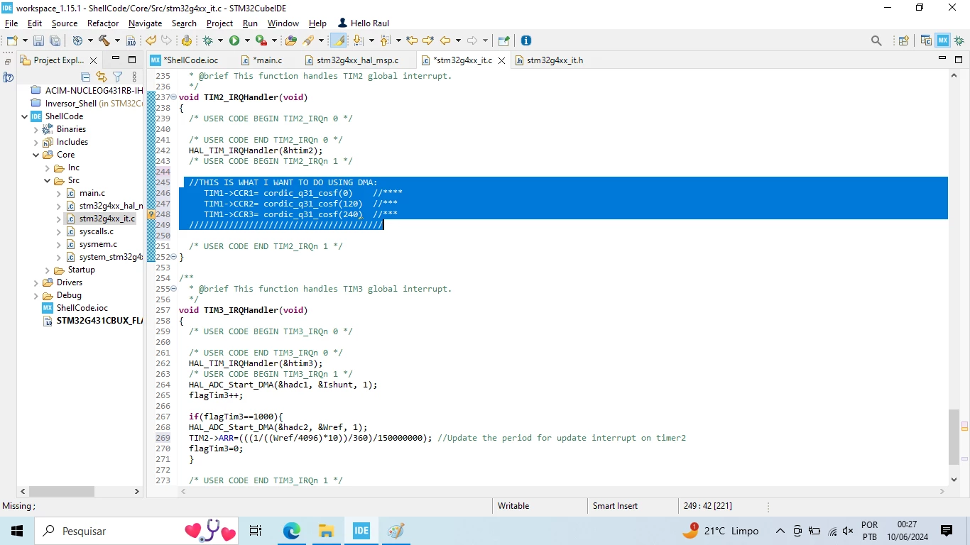

Hello there, Sarra.S! Thank you for your answer. I have updated the post with some code snippets.
June 10, 2024
In the image above, there's a section marked in blue, which is what I'd like to implement using DMA. Below, I attempted a different approach but without success.
