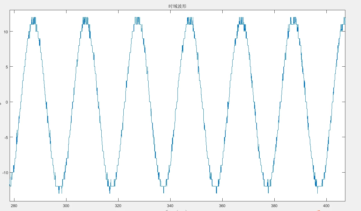

Hi,everyone.I'm use NUCLEO-L496ZG platform.
ADC1 sample at a frequency of 5M,ADC3 sample at a frequency of 12.8K(PWM trigger).
when only run ADC3,ADC3's waveform is normal.
when ADC1 and ADC3 run at the same time,ADC3's waveform has a lot of interference.How to solve this problem? if had recommend frequency of ADC1 when ADC3 sample at a frequency of 12.8K? ADC1's frequency nend greater than 2M.
Time-domain waveform of ADC3(only ADC3 sample)
Time-domain waveform of ADC3(ADC3 and ADC1 sample together)0693W000006HMSyQAO.png

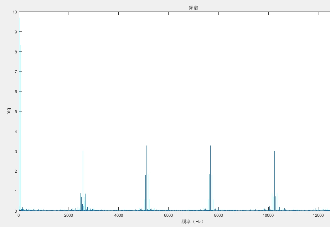

Frequency spectrum waveform of ADC3(ADC3 and ADC1 sample together).

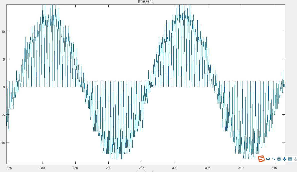

0693W000006HUpqQAG.pngThe follow picture is Enlarged view.(ADC3 and ADC1 sample together)
Input signal.
0693W000006HUqZQAW.pngInterference signal. The same of other three. Interval of frequency is 2560Hz

The second image clearly shows that every n-th positive sample is 0 and every n-th negative sample is 1, which is probably because of some off-by-one processing error. Therefore look for wrong buffer address/size and flaws in processing code.
