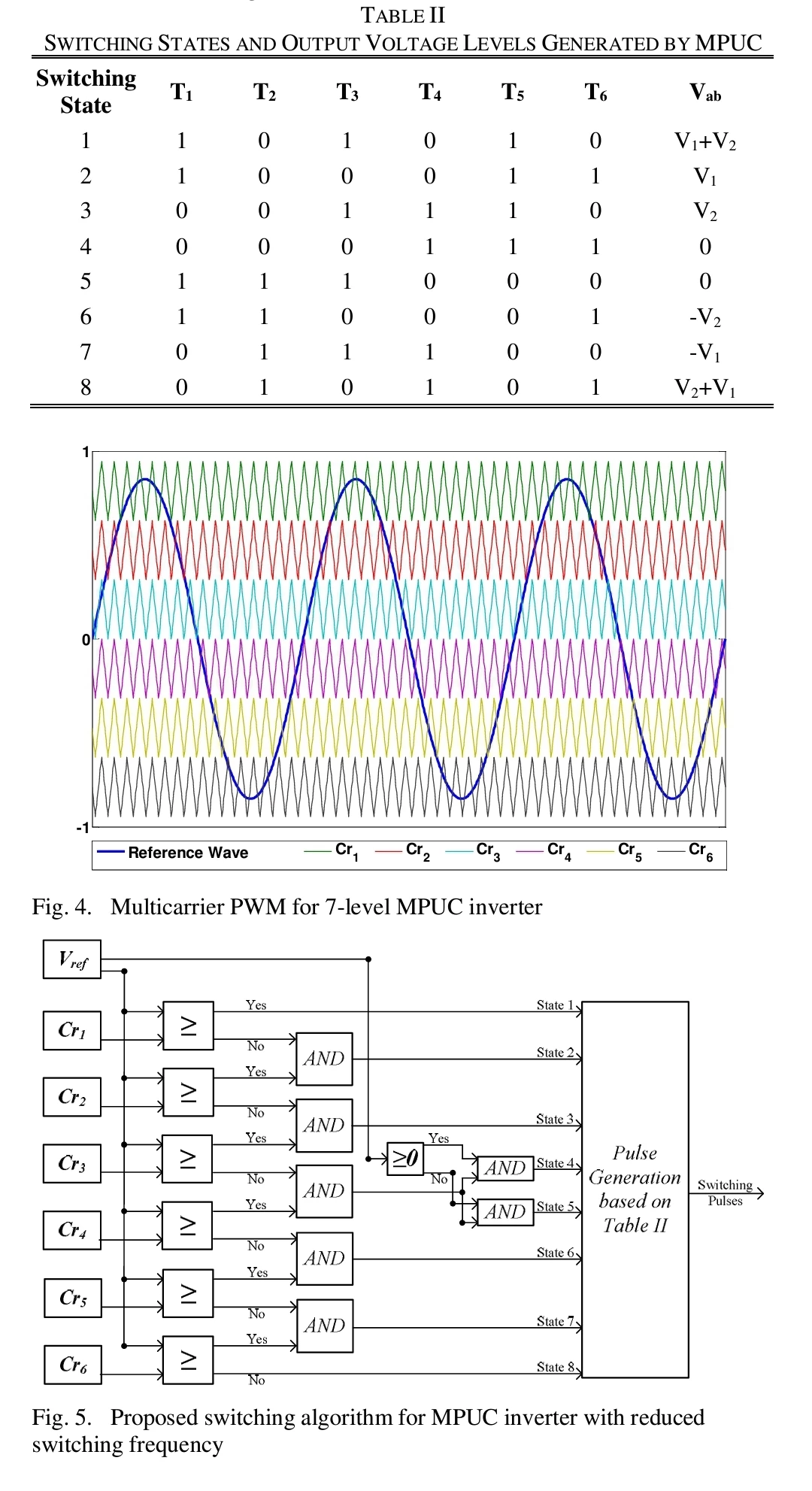

How generate multicarrier PWM on stm32? Currently my project is making Modified seven level packed u cell inverter.

Perhaps DMA a pattern buffer to the GPIO ODR or BSRR, paced with a TIM
