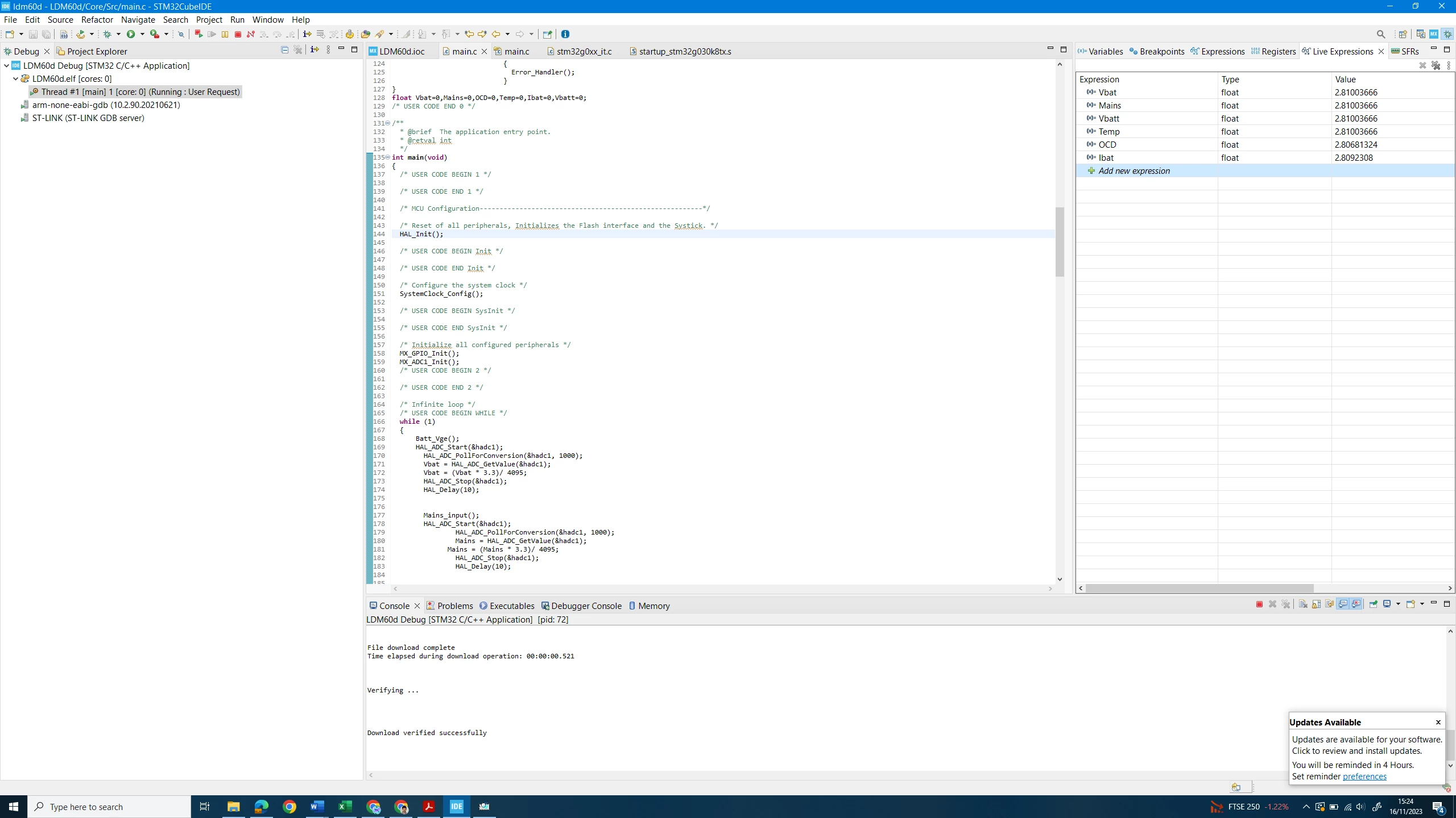

raptorhal2
Lead
November 15, 2023
You are converting only one channel at a time. Set NbrOfConversions = 1.

meenaAuthor
November 16, 2023
I am getting  same values for all channels
