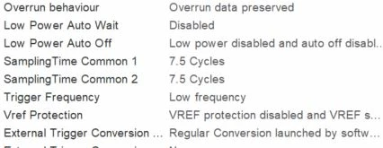

5- End of Conversion selection is set to End of Sequence of conversion (not single conversion) which should mean the EoC is True only after the two channels are converted (right?)
6- SamplingTime common 1&2 are set to 7.5 (I'm not sure why there are two)
7- Trigger Frequency is set to Low

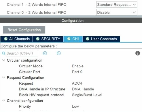

8- I'd like to use Regular Conversion Launched by SW at the beginning and later use a Timer to automate this process. But this means that every time I need fresh transfers I need to call HAL_ADC_Start_DMA(&hadc4, (uint32_t*)adcResultsDMA, 2); or only once suffices?
9- I used DMA channel1 from GPDMA1 in Standard Request Mode
10- Circular mode is enabled and Port 0 is selected
11- Request is set to ADC4. Data Width is set to HalfWord (12 bit adc, hence 16 bits of FIFO) for both the source and the destination and by ST recommendation the Burst Length is set to 1
12- In the end, GPDMA1 Channel 1 global interrupt is enabled

For people who might face the same issue. After a few tough days, I realized one should manually supply the ADC by calling a function. STM Cube IDE is supposed to this automatically but it seems it is a bug in the generate code. To supply the ADCs one should put this line before ADC_Init functions:
HAL_PWREx_EnableVddA();
Otherwise the ADC does not work to begin with. My settings were correct so if anyone seeks the same approach, they can take it.
