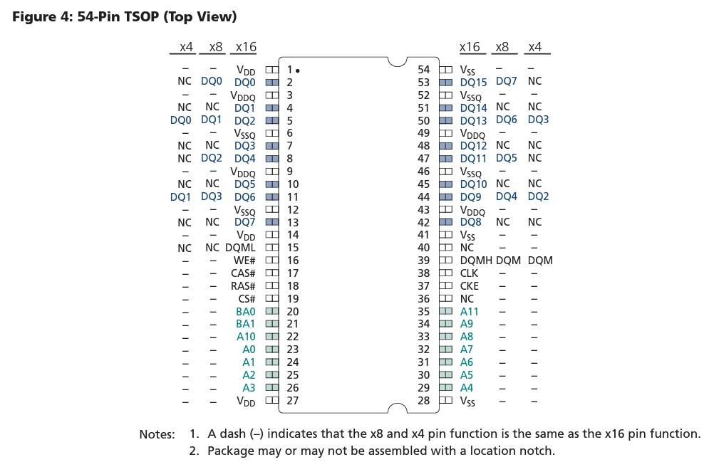

MT48LC4M16A2 is avilable with STM32H735IGT6?
I wonder how can I connect pins between two chips?
MCU doesn't have pins about MT48LC4M16A2's DQML, DQMH, BA[1:0] etc.
