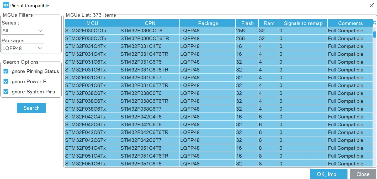

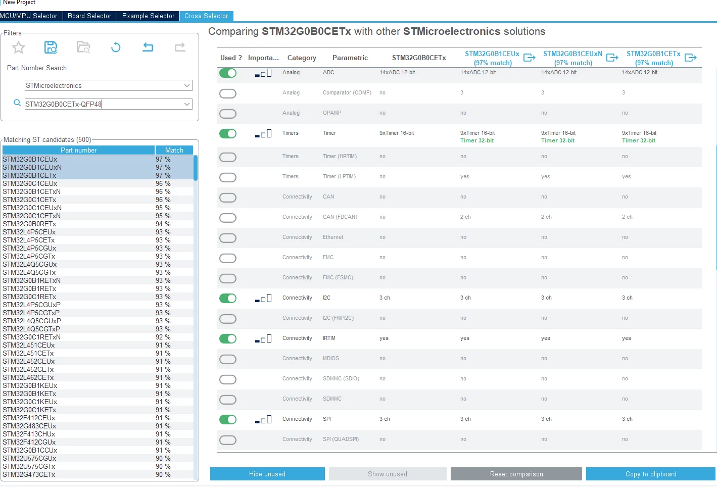

Also, you can use both Cross Selector:
and Pinout compatibility feature:
available using STM32CubeMX.

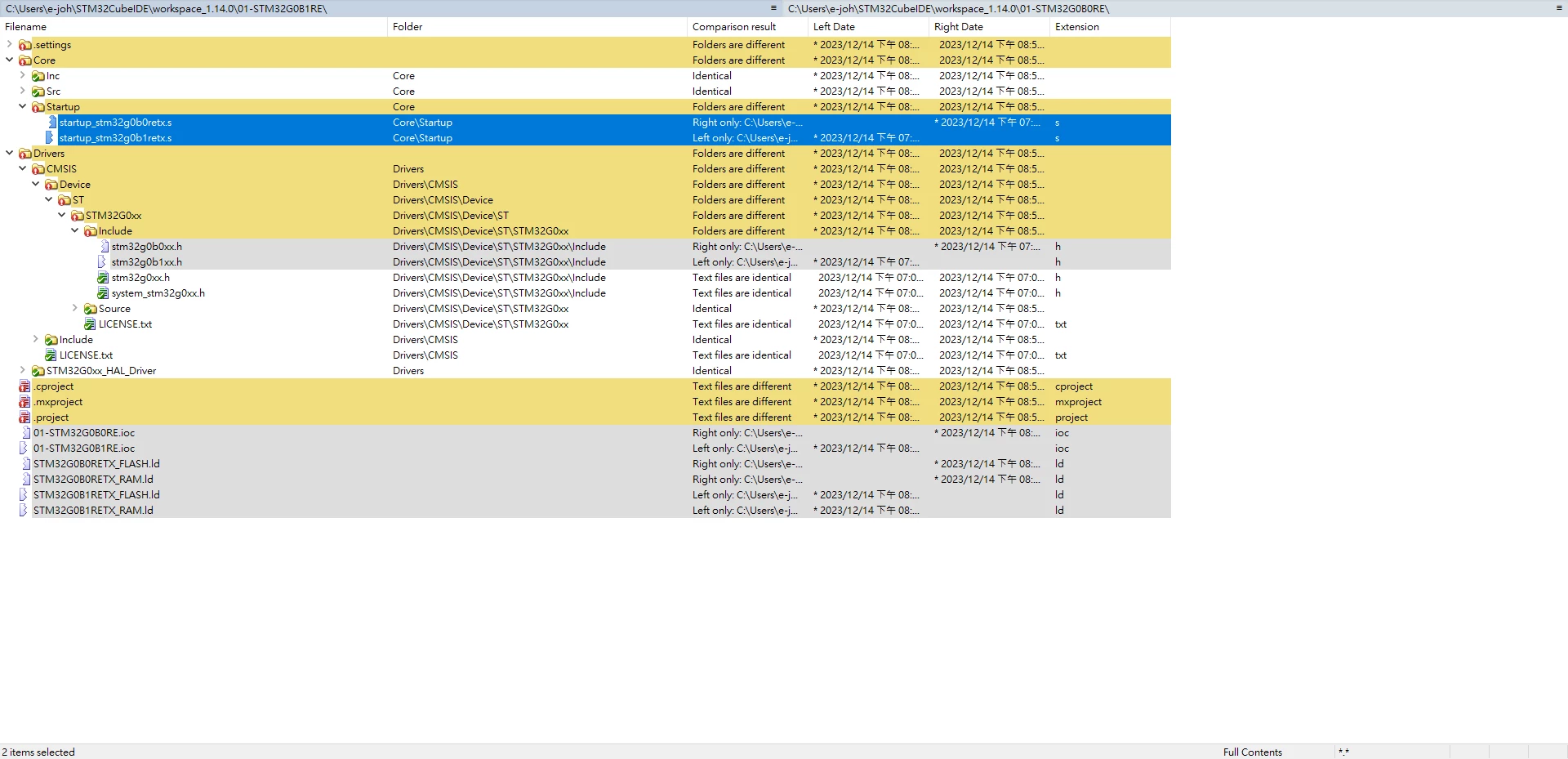

E-John
E-JohnAuthor
December 14, 2023
@STTwo-32
You have to take care of some differences in hardware, peripheral availability, firmware, security, and tools.
---> Here are what I have found.
1. make projects 01-STM32G0B0RE and 01-STM32G0B1RE by STM32CubeIDE tool
    Make code generated by tool.
2. Make a comparison between two projects directories like below
3. Different files are startup, CMSIS and linker scripts, see table below
 STM32G0B0RESTM32G0B1RE
startup file
01-STM32G0B0RE\Core\Startup\
startup_stm32g0b0retx.s
01-STM32G0B1RE\Core\Startup\
startup_stm32g0b1retx.s
CMSIS
01-STM32G0B0RE\Drivers\CMSIS\Device\ST\STM32G0xx\Include\
stm32g0b0xx.h
01-STM32G0B1RE\Drivers\CMSIS\Device\ST\STM32G0xx\Include\
stm32g0b1xx.h
linker script for flash
01-STM32G0B0RE\
STM32G0B0RETX_FLASH.ld
01-STM32G0B1RE\
STM32G0B1RETX_FLASH.ld
linker script for ram
01-STM32G0B0RE\
STM32G0B0RETX_RAM.ld
01-STM32G0B1RE\
STM32G0B1RETX_RAM.ld
4. HAL level drivers seems to be the same.

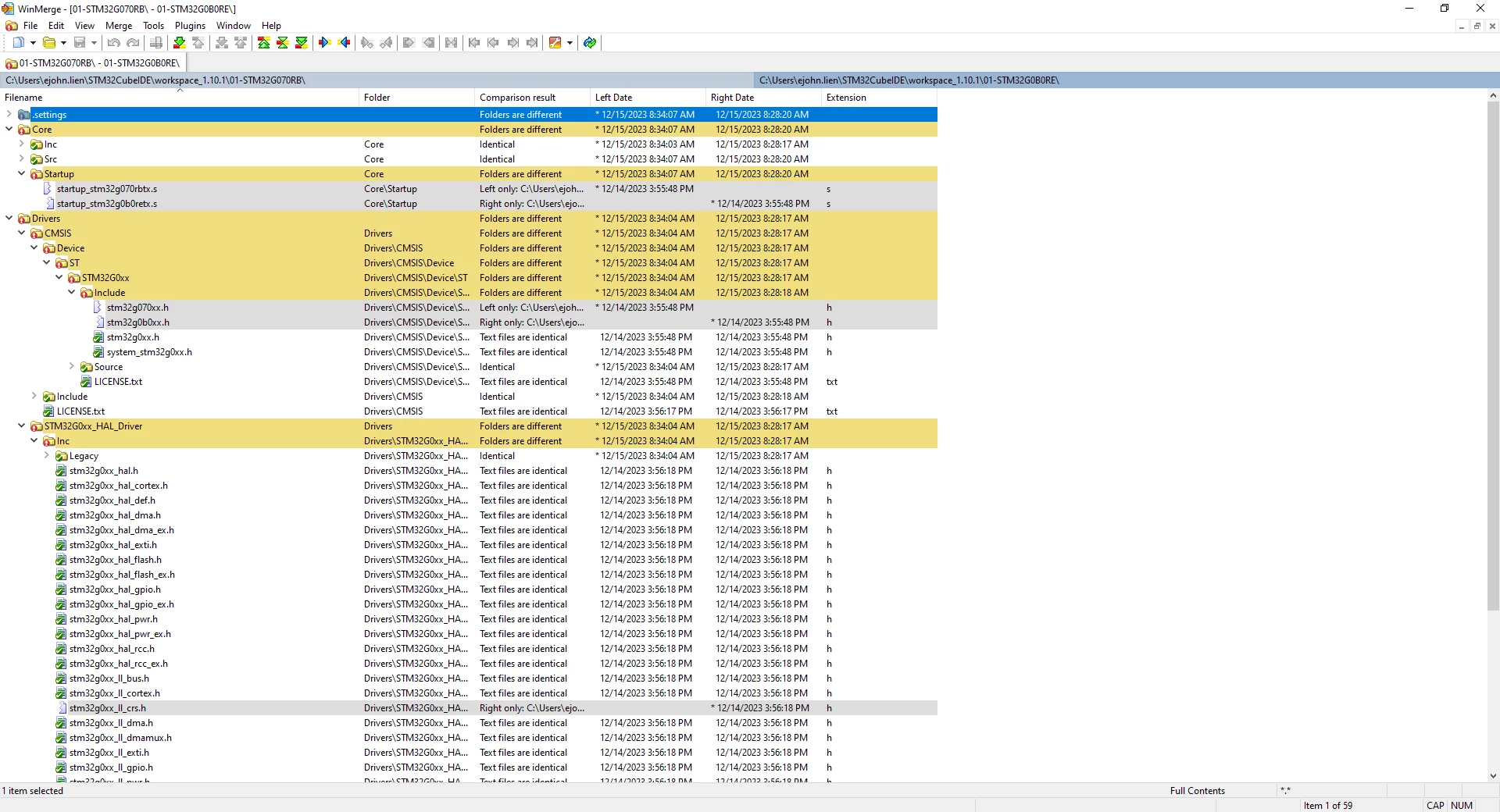

E-John
E-JohnAuthor
December 15, 2023
@PieterInHetBos
make projects 01-STM32G0B0RE and 01-STM32G070RB by STM32CubeIDE tool.
Compare these two directories, the startup file, header files under CMSIS\Device\ST\STM32G0xx\Include\ and linker scripts are still different.
The best way I can think is to create two projects for different platforms, and merge the hardware independent code from 070 to 0B0.
