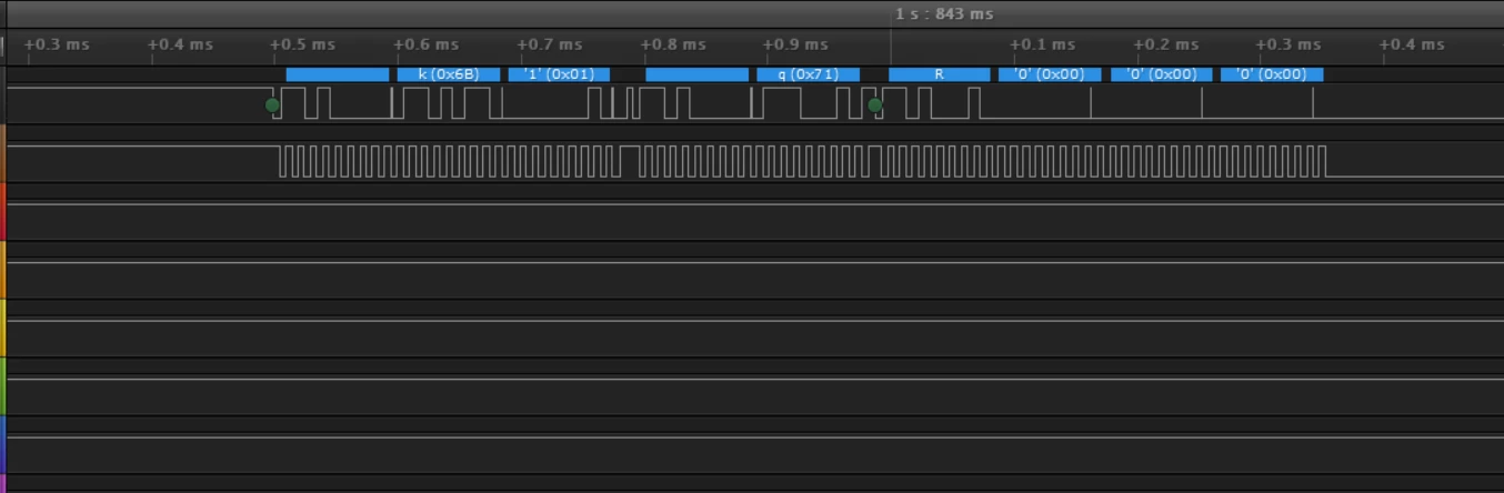

I am working with MPU6050 and STM32f103VE as master. When I wake up the sensor and ask for information it returns 3 bytes of zeroes and the protocol stops working. I only send the communication Part of my code to be more specific:

The first part of the code is responsible for clearing register
0x6B
 in order to wake MPU up. The second part reads the requested register information. And here is what I get from the communication.
