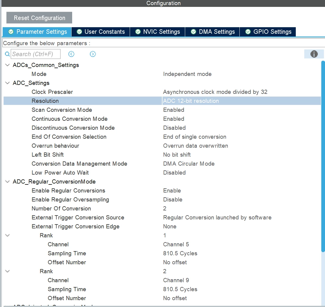

I have Nucleo-H743ZI, on which two pins are configured for ADC reading { PB0(CH9) & PB1(CH5) }with circular DMA continuous conversion mode, but only PB1 is able to read data when
HAL_ADC_Start_DMA(&hadc1, (uint32_t *)ADC_Data, 2);
starts reading the data in continuous conversion mode,
the configured ADC settings are as follow:
static void MX_ADC1_Init(void)
/* USER CODE BEGIN ADC1_Init 0 */
/* USER CODE END ADC1_Init 0 */
ADC_MultiModeTypeDef multimode = {0};
ADC_ChannelConfTypeDef sConfig = {0};
/* USER CODE BEGIN ADC1_Init 1 */
/* USER CODE END ADC1_Init 1 */
/** Common config
hadc1.Instance = ADC1;
hadc1.Init.ClockPrescaler = ADC_CLOCK_ASYNC_DIV32;
hadc1.Init.Resolution = ADC_RESOLUTION_12B;
hadc1.Init.ScanConvMode = ADC_SCAN_ENABLE;
hadc1.Init.EOCSelection = ADC_EOC_SINGLE_CONV;
hadc1.Init.LowPowerAutoWait = DISABLE;
hadc1.Init.ContinuousConvMode = ENABLE;
hadc1.Init.NbrOfConversion = 2;
hadc1.Init.DiscontinuousConvMode = DISABLE;
hadc1.Init.ExternalTrigConv = ADC_SOFTWARE_START;
hadc1.Init.ExternalTrigConvEdge = ADC_EXTERNALTRIGCONVEDGE_NONE;
hadc1.Init.ConversionDataManagement = ADC_CONVERSIONDATA_DMA_CIRCULAR;
hadc1.Init.Overrun = ADC_OVR_DATA_OVERWRITTEN;
hadc1.Init.LeftBitShift = ADC_LEFTBITSHIFT_NONE;
hadc1.Init.OversamplingMode = DISABLE;
if (HAL_ADC_Init(&hadc1) != HAL_OK)
Error_Handler();
/** Configure the ADC multi-mode
multimode.Mode = ADC_MODE_INDEPENDENT;
if (HAL_ADCEx_MultiModeConfigChannel(&hadc1, &multimode) != HAL_OK)
Error_Handler();
/** Configure Regular Channel
sConfig.Channel = ADC_CHANNEL_5;
sConfig.Rank = ADC_REGULAR_RANK_1;
sConfig.SamplingTime = ADC_SAMPLETIME_810CYCLES_5;
sConfig.SingleDiff = ADC_SINGLE_ENDED;
sConfig.OffsetNumber = ADC_OFFSET_NONE;
sConfig.Offset = 0;
sConfig.OffsetSignedSaturation = DISABLE;
if (HAL_ADC_ConfigChannel(&hadc1, &sConfig) != HAL_OK)
Error_Handler();
sConfig.Channel = ADC_CHANNEL_9;
sConfig.Rank = ADC_REGULAR_RANK_2;
Error_Handler();
/* USER CODE BEGIN ADC1_Init 2 */
/* USER CODE END ADC1_Init 2 */

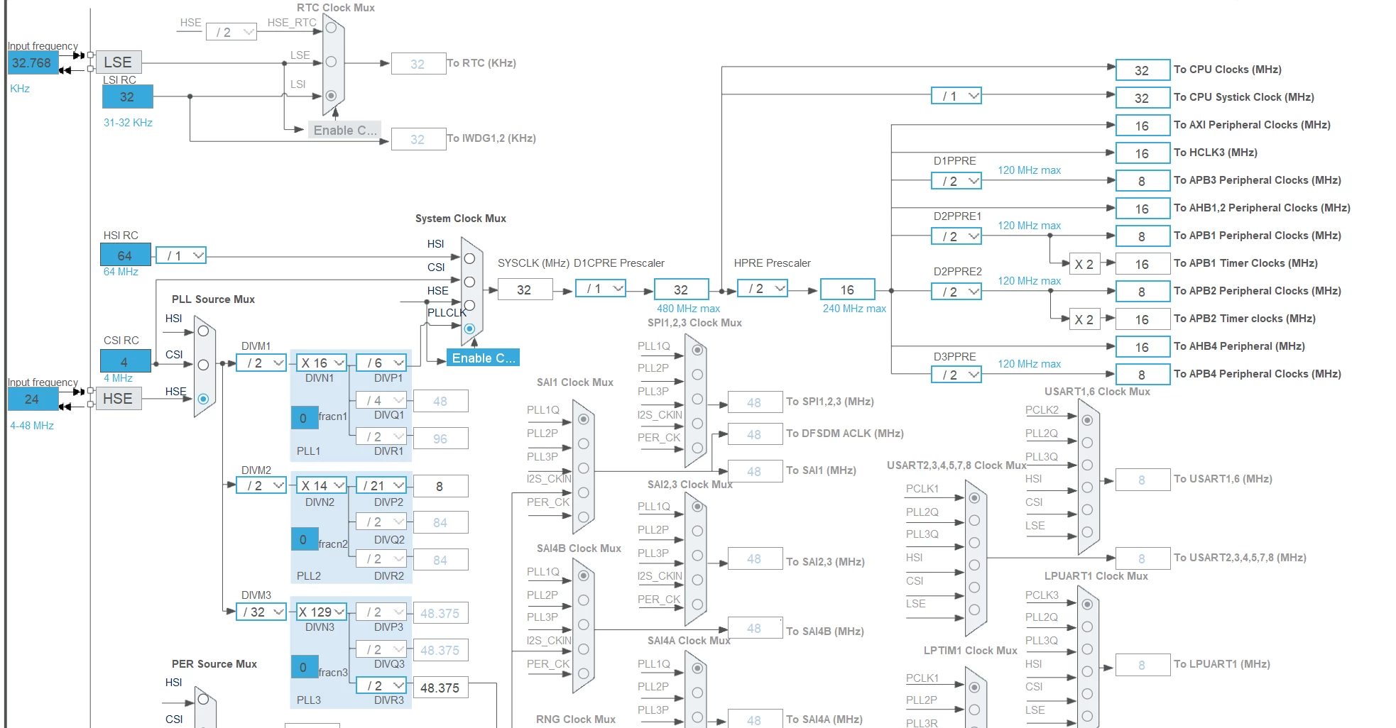

  • giving 8MHz to the ADC, is this the correctly configured with respective pins just guide me in the right direct or a blog in which its implemented
    for now testing with Nucleo but i want to read 6 ADC's in total for this project for custom board

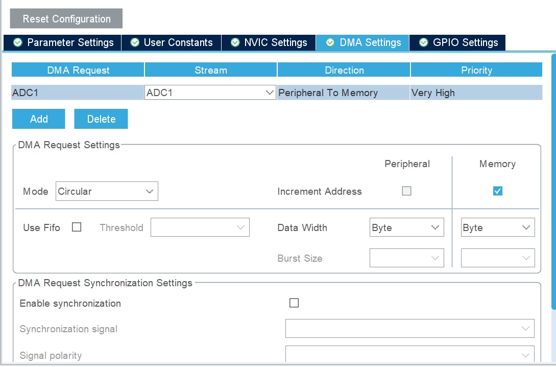

here I am sending an example which should help you with ADC settings. For reading data from ADC channels by DMA in circular mode, there should be some periodic ADC trigger, for example ADC should be periodically triggered by TIMx as it is in attached example.
Try to reconfigure ADC as Continuous conversion DISABLED, External Trigger Conversion Source to Timer 3 Trigger Out event.
DMA set to Half-word Data Width (due to 12-bit resolution)
Configure TIM3 as Clock source Internal, Prescaler to 999, Counter Period 15, Trigger Event Selection TRGO to Update Event.
In program you should first start TIM (HAL_TIM_Base_Start(&htim3);) and than start DMA transfer by HAL_ADC_Start_DMA(&hadc1, (uint32_t *)ADC_Data, 2);
After that every 1ms should be converted one ADC channel and result should be transfer to memory.

DMA should be set to half-word if you're using uint16_t values.
