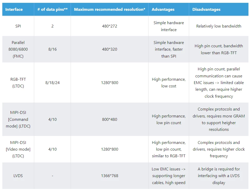

Hello @mdalal ,
Need to select first an LCD display on the market and find if it does have any available interface compatible with U5 product: FMC, SPI, I2C etc .. Some displays can be driven directly by GPIOs ..
TouchGFX runs on any kind of display, and is not dependent on display technologies, interfaces, viewing angles, brightness etc but these are the display resolutions recommended for TouchGFX to achieve the intended performance: (according to this Link)

September 10, 2024
Hello @mdalal ,
