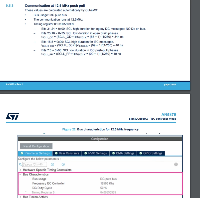

How can we define separate frequency for open drain and push pull modes for I3C communication ?
In the documentation only the low phase is mentioned but for high phase there's no separate option for OD & PP modes.
Ideally I would like to do something like this
<Context> I am working with  STM32H5RB03 as the controller and a MEMS sensor as the target. I want to do I3C communication at 12.5Mhz but the initial OD phase should have much lower frequency(<2Mhz) in order for the sensor to ACK(respond). I'm a newbie so might make basic mistakes while formulating my question, please ask if you need more clarity.

Hello @Asfand ,
You can't define separate frequency for open drain and push pull modes for I3C communication in STM32CubeMx.
So after generate code, you should set the desired frequency

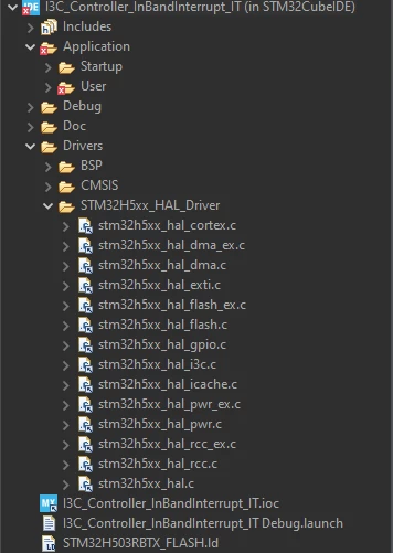

Hi @Foued_KH
Thanks for the prompt reply.
I am using STM32CUBEIDE and it can not recognize the function 'I3C_CtrlTimingComputation' & definition 'I3C_PURE_I3C_Bus'. I have generated the example 'I3C Controller Inband interrupt' from STM32CubeMx by selecting appropriate board(not using example from Git repo).
Are these functions/definitions not included when we generate code from STM32CubeMx? If yes, can you point to the specific files I should look for ?
For ref:
Let me know If I'm missing something.
