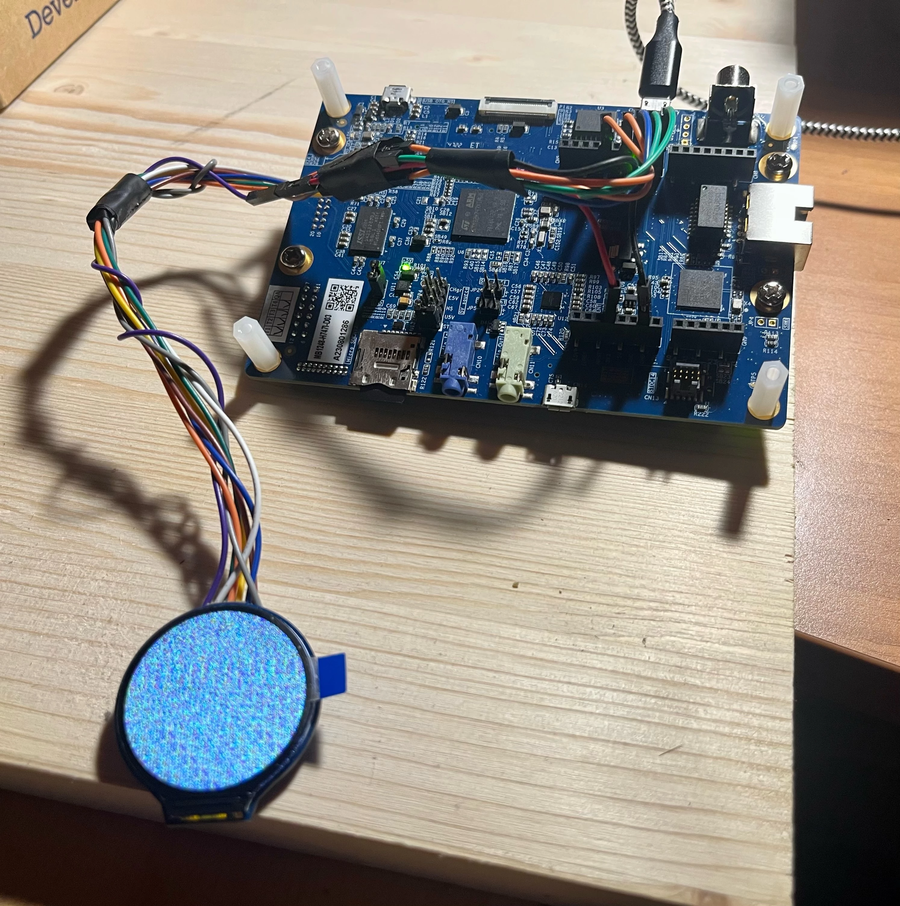

I recently bought an STM32H747I-DISCO board and I'm trying to run the JPEG_MJPEG_VideoDecoding code example with an external display. The code works fine with the on-board display, but I'm struggling to get it working with an external display that uses a GC9A01 driver.
I'm confident the issue isn't with the new display or its associated code because I've successfully tested it with static JPEG decoding (not MJPEG). I suspect the problem lies within the code example I'm trying to modify, specifically in the DMA2D section. It appears that the external DRAM is not written to during the final phase of the decoding by the DMA2D peripheral. As a result, when I run my lcd_draw() function, it shows garbage on the display.
My modifications to the original code involved disabling all on-board LCD functions and replacing them with my own LCD functions.
Can you help me understand why it doesn't work?
It follows the part of code I modified and an image.

STOne-32
July 20, 2024
Dear @AFato.3 ,
May be it is a Cache coherency issue , CPU / Cortex-M7 is trying to display data generated from DMA2D .  Is that possible to add
 CleanIvalidate before lcd_draw() function and let us know if it helps ?

AFato.3
AFato.3AuthorBest answer
July 22, 2024
Hi @STOne-32 ,
Thank you for your reply. I found out the problem, it was that the low level configuration of the DMA2D in that example was not placed in the stm32h7xx_hal_msp.c file as for the other peripherals, but it was in another file which I excluded because not relevant for my application. I solved the problem copying that part of the code into the stm32h7xx_hal_msp.c file.
