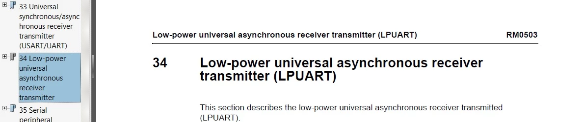

4. Usually each section name ends with an abbreviated name in parenthesis. Ex: Low-power universal asynchronous receiver transmitter (LPUART). And this abbreviated name is also in bookmarks on the left size of each RM. But (LPUART) is not in bookmarks in several RM possible all from the beginning.

AA1Author
Senior III
Apr 28, 2024 2:29 PM UTC
The blue text on the left should also end with (LPUART). I know this is insignificant and I just talked about this because I wrote this post due to other things.
STTwo-32
Apr 28, 2024 2:34 PM UTC
Hello @AA1
This is included on the Rev 2 of the doc. Could you please check.
