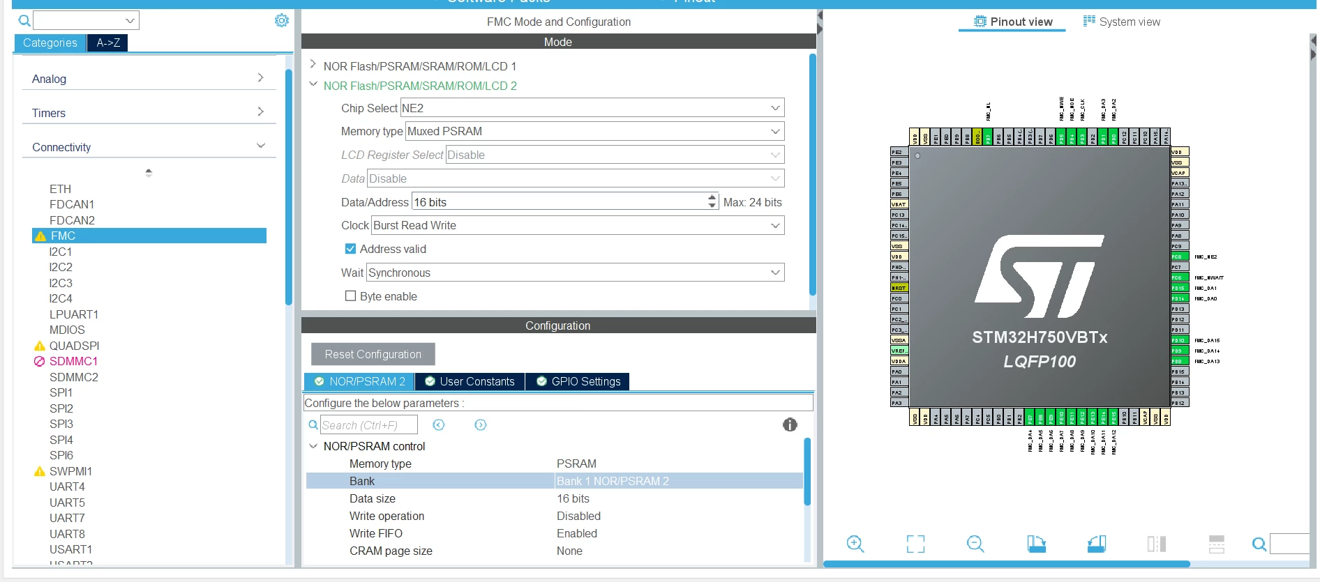

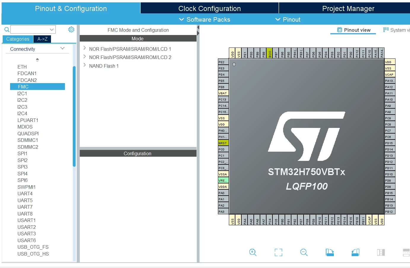

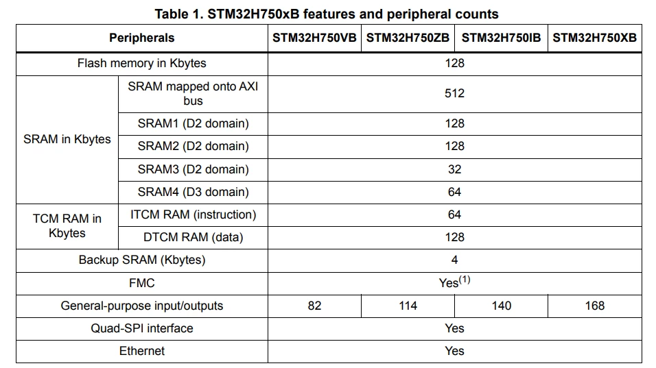

Hi, I'm developing a STM32H750VBT6 board that need SDRAM, the datasheet said that only LQFP144 package does not support SDRAM, but I cannot find SDRAM option in FMC configuration. Can someone please help me.Screenshot 2024-07-28 141009.png

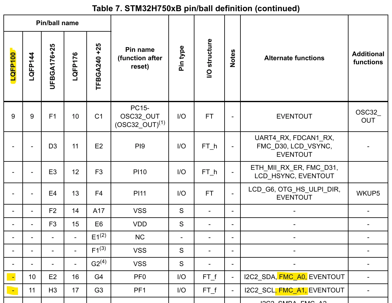

SDRAM is not available on the LQFP100 due to the missing A0, A1 pins (among others).
Contrary to the datasheet, SDRAM is available on the LQFP144 according to CubeMX and my own brief analysis.
@Amel NASRI Can you please look into this?

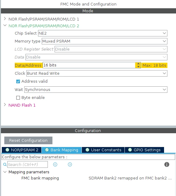

AScha.3
July 28, 2024
(i never tried before...but) here on H750V ,
seems little bit "hidden" , only bank2 can be sdram :
htMercuryAuthor
July 28, 2024
I tried following your configuration but mine donot have Bank Mapping configuration. Can you please a little bit more detail ?

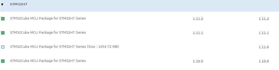

AScha.3
July 28, 2024
No detail - i just have it there. :)
Maybe - different H7 packs, i have:
- using still V1.10.0 with MX 6.9.1   -- maybe there something different in version you use.

Tesla DeLorean
Guru
July 28, 2024
I'd be surprised that the 100 pin part exports all the pins needed for SDRAM and the 144 pin doesn't.
Go through the pin table in the Data Sheet and check manually.

Amel NASRI
July 29, 2024
Hi @TDK ,
Thanks for bringing this issue to our attention. This is reported internally (Internal ticket number 187681).
-Amel
