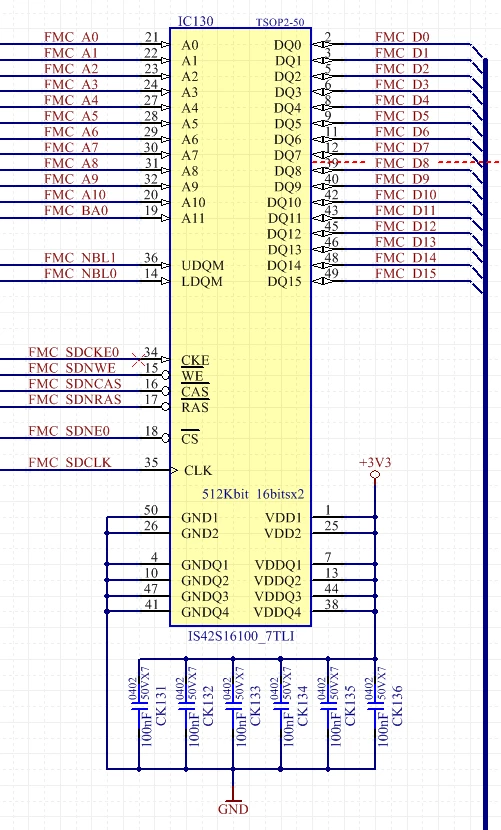

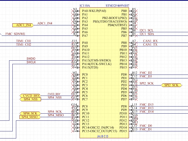

Missing SDNWE signal using STM32F469NI and SDRAM on PA7
Posted on October 06, 2016 at 16:01
The original post was too long to process during our migration. Please click on the attachment to read the original post.

    > Note that in other examples, SDNWE is mapped to PC0, but this was not possible in this design. According to the datasheet, PA7 should also work for SDNWE.
    Just as an experiment, could you try to map SDNWE either to PC0 or PH5? The SDRAM won't work but you could at least check if there is any activity on those pins.

    Unfortunately, this is not possible in this design because the STM32 in question is in a BGA package and the other alternate pins are not accessible because they are not fanned out. :(

    Another way to prove/distinguish software error from genuine silicon bug would be to use a 469-DISCO - while /WR of SDRAM there is connected to PC0 , PA7 is freely available on the Arduino connector thus activity could be measured there easily.

    OK, reporting back...
    I got one F469I Discovery board and tested the same code as shown above... Ignoring the fact that the SDRAM on the discovery board is of another type (32 bit and 4 banks), the pin PC0 (test pad TP2) produces a valid SDNWE signal. Remapping SDNWE to PA7 (as it is designed in my own PCB) and measuring at Arduino connector D9 (= PA7), I only get a constant LOW signal - just like in my own hardware design. I will show the code for the initialization of the FMC GPIOs again, with the slight modification that both PA7 and PC0 are mapped to SDNWE. It does not matter if PC0 AND PA7 are mapped to SDNWE or if the initialization code of PC0 is disabled. The result is the same (no activity on PA7).

    So I come to the conclusion that there is probably a silicon bug in the microcontroller. Can someone from ST confirm that or maybe provide a workaround? Kind regards, André

    A quick follow-up to this problem:
    The limitation was confirmed by ST and should get published in the errata sheet.

    Please note that the limitation is described in
    http://www.st.com/content/ccc/resource/technical/document/errata_sheet/group0/a3/1d/3c/4b/9a/d2/46/46/DM00220774/files/DM00220774.pdf/jcr:content/translations/en.DM00220774.pdf
    as following:
    Title: FMC_SDNWEN alternate function on PA7
    Description
    The FMC_SDNWEN alternate function  is not available on PA7.
    Workaround
    Use FMC_SDNWEN alternate function on PH5 or PC0.
    A request will be raised internally to take into consideration this limitation in STM32CubeMX.
