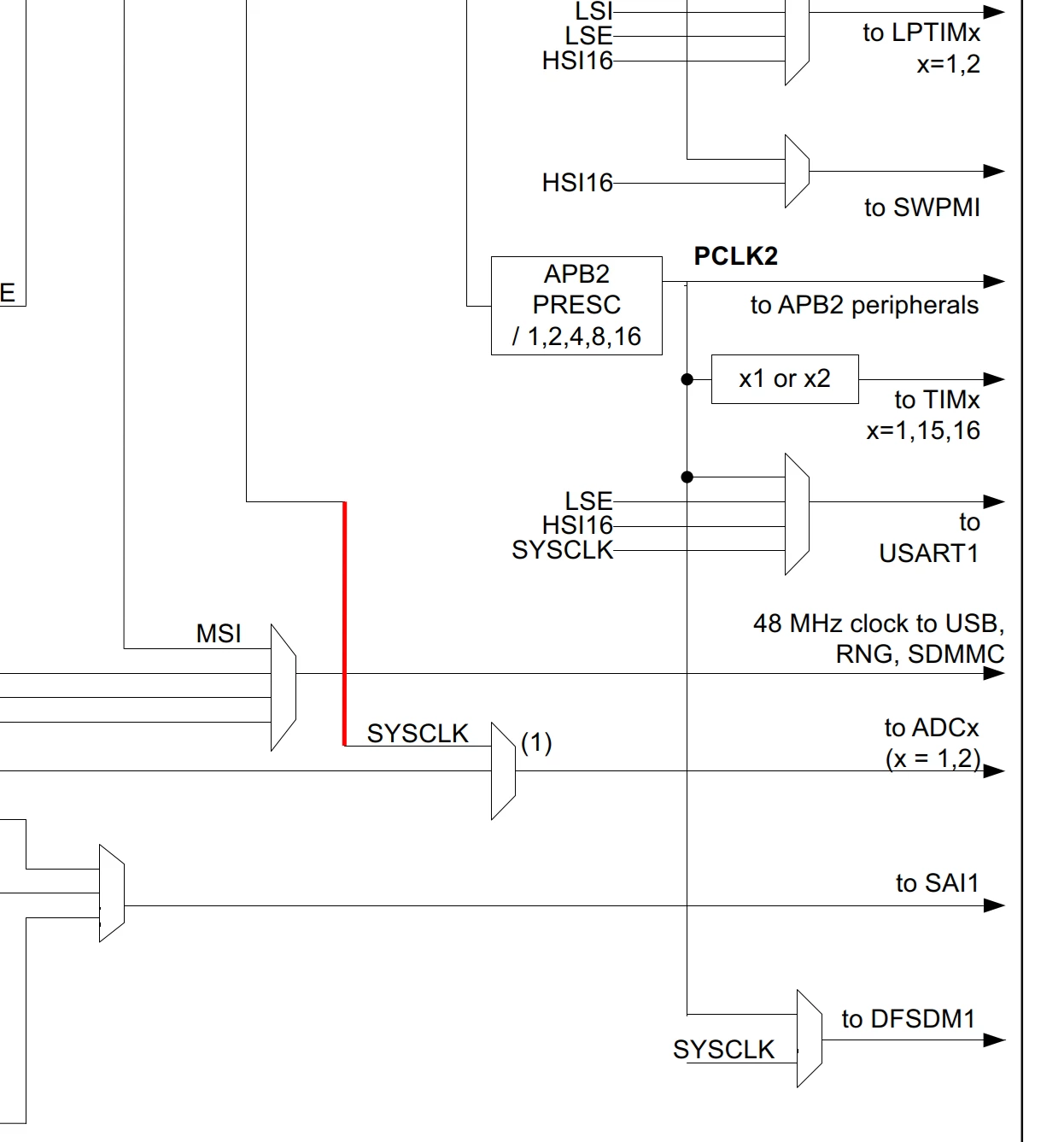

Missing line in clock tree in RM0394
Can ST please fix this minor interconnection line missing in the RCC clock tree figure in RM0394.
mƎALLEm
mƎALLEmBest answer
Jul 20, 2026 1:14 PM UTC
This error has been introduced in revision 4 issued in 2018. Missing link from SYSCLK line shall go to line named SYSCLK:
That will be fixed when a new revision of the document is planned for release. As this product is considered as fully mature, the document will take a considerable time for update.

mƎALLEm
Jul 17, 2026 6:54 AM UTC
Hello ​@waclawek.jan ,
I’ll escalate it for analysis and eventual fix.
Thank you for your contribution.
mƎALLEm
mƎALLEmBest answer
