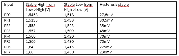

I tried to measure directly at the pins PF0 to PF7 of a nucleo STM32F767ZI to get a better idea of the real situation.
What I can see is, that PF0 to PF5 toggle extremly when starting at 0V and turn up the voltage slowly. They start toggeling at 1,50V. From High to Low they start toggeling at 1,55V. PF6 and PF7 don`t toggle and they have a hysteresis which is not lower than 100mV.
Here the measured values:
As you see, the 10%VDD Hysteresis (VDD = 3,13V) does not exist on 6 of the 8 pins.
Best regards
Volker

Can I believe on the levels for VIL and VIH given in the datasheet with "guaranteed by design", when the hysteresis (guaranteed by design) is not exactly like defined in the datasheet?

Well, at least you've found some hysteresis, which is the intention of the Schmitt trigger. Please refer to Table 66 and the Parameter column that indicates for Vhys: FT, TTa and NRST I/O input hysteresis. It looks like you want to use this for standard GPIO, i.e. not for the 5V tolerant, 3.3V tolerant ADC or NRST pins.
However, please do not stick to the use of these simple Schmitt triggers for analog measurement functions, as a measurement with an ADC channel should be the better approach. You could maybe trigger the ADC by a timer and use the analog watchdog function of the ADC to get an interrupt when the input voltage goes
beyond the user-defined, higher or lower thresholds.
