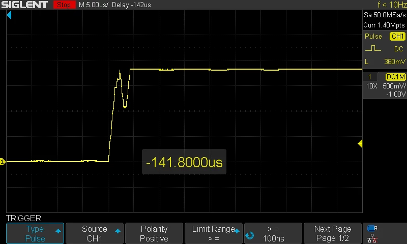

But I don't understand why the fix works... it makes no sense to me. NSS goes high/low in about 200ns (measured with probe, ultra short GND connection). A different measurement showed 1300ns (with long lead on the probe).
The datasheet states 320ns with a 50pF capacitance. So the first measurement should be ok. 200ns is about 3 clock cycles.

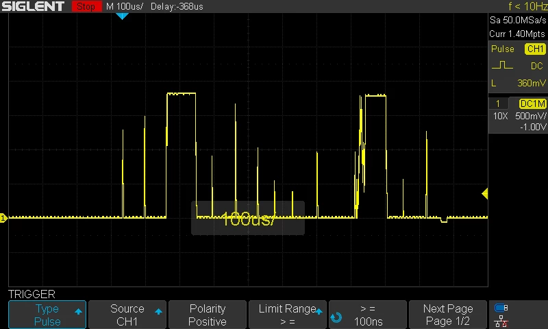

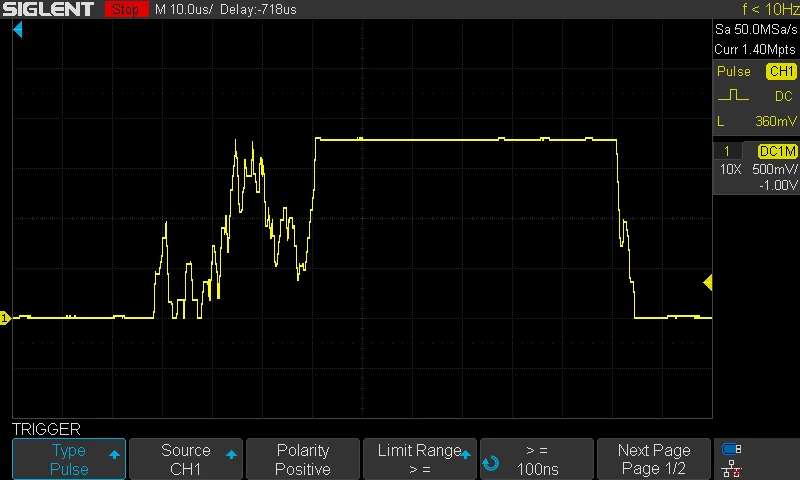

Why is MOSI on the oscilloscope so broken? How come I can even send correct messages with such a MOSI graph? See attached picture. MOSI has a rise time of about 2.5us. Which is way too long. Why? If it was because of the oscilloscope, I'd see the same phenomenon on SCK, NSS or MISO. But I don't.

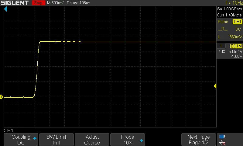

This is NSS - the rise/fall times would be way faster without the oscilloscope probe.

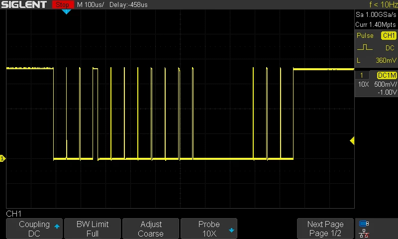

Regarding the MOSI scope thing:
If I select a finer resolution like 50us instead of 2ms on the scope, then I get clean edges and fast rise times of ~50ns. So it seems to have to do with the scope settings.

AScha.3
November 21, 2022
this is just wrong setting of DSO .
to see fine pulses in big time window, you have to set Acquire (button on scope) to "Peak Detect" .
then you see correct SPI signal.

ramses946
ramses946Author
November 21, 2022
@AScha.3​ thank you, yes, I noticed that the distorted MOSI signal must have to do with the scope settings. I will switch to "Peak Detect" next time following your advice.

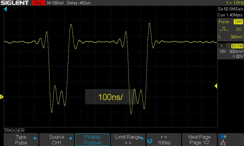

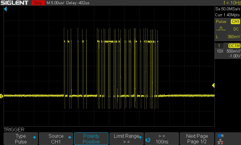

This is what MOSI looks like in peak-detect acquisition mode.
There is a pretty strong overshoot of 700mV and undershoot of -500mV.
A possible explanation for the missing bytes could be that maybe SCK is ringing. So some SCK cycles could be missing maybe? But that would not explain why waiting after pulling NSS low fixes it.
I think, the ringing could even be worse without the probe. Because the rise time should be much higher without the probe capacitance...
P.S.:
I've changed SPI GPIO settings now from VERY HIGH to HIGH. After this change the under-/overshoot is smaller.
I've also tried MEDIUM but using this setting the communication did not work anymore.
AScha.3
November 21, 2022
just i want write abour port speed - now you found it yourself:
always set lowest speed, that gives perfect result. more speed - more overshoot.

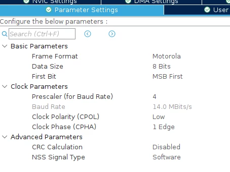

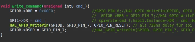

>I initialize a 60 byte array and do a 30 byte memcpy after pulling NSS low. That should be enough time for NSS to become low.
must be something in your code, i drive a TFT with F103 / SPI at 14 MHz, but clkpre div 4 (try!)
see:
0693W00000WJ4jkQAD.pngand there are many bytes to send... more than 60 :)
i write direct to register :
0693W00000WJ4p4QAD.pngthe "useless" HAL- gpio write makes the needed delay for the spi , about 720ns ;
NSS is direct write to port gpioB bit set / reset , absolutely no delay needed !

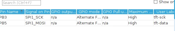

i had high setting for TFT spi on all lines:
0693W00000WJ5XQQA1.pngabout port speed: basically connecting small/more../big mosfets to the output stage -> changes swichting speed, but always depending on load (xx pF) .
i made tests with the SD-card driver, at full speed (50MHz) : most micro-SDcard not responding at all, when highest port speed set. but with medium/high running perfect, at low speed no function.
so too much speed here producing reflections, that prevent function.
