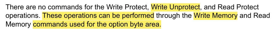

September 1, 2026
@Elmue To change option byte settings, use the Write Memory command, as described in AN3156. This is available in the USB DFU bootloader.
This will cause a system reset to apply the new option bytes:
The option byte registers/fields are given in the reference manual.
You should use Read Memory command to get current settings, change the write protection field, and then Write Memory to write the new value with the other fields unchanged.

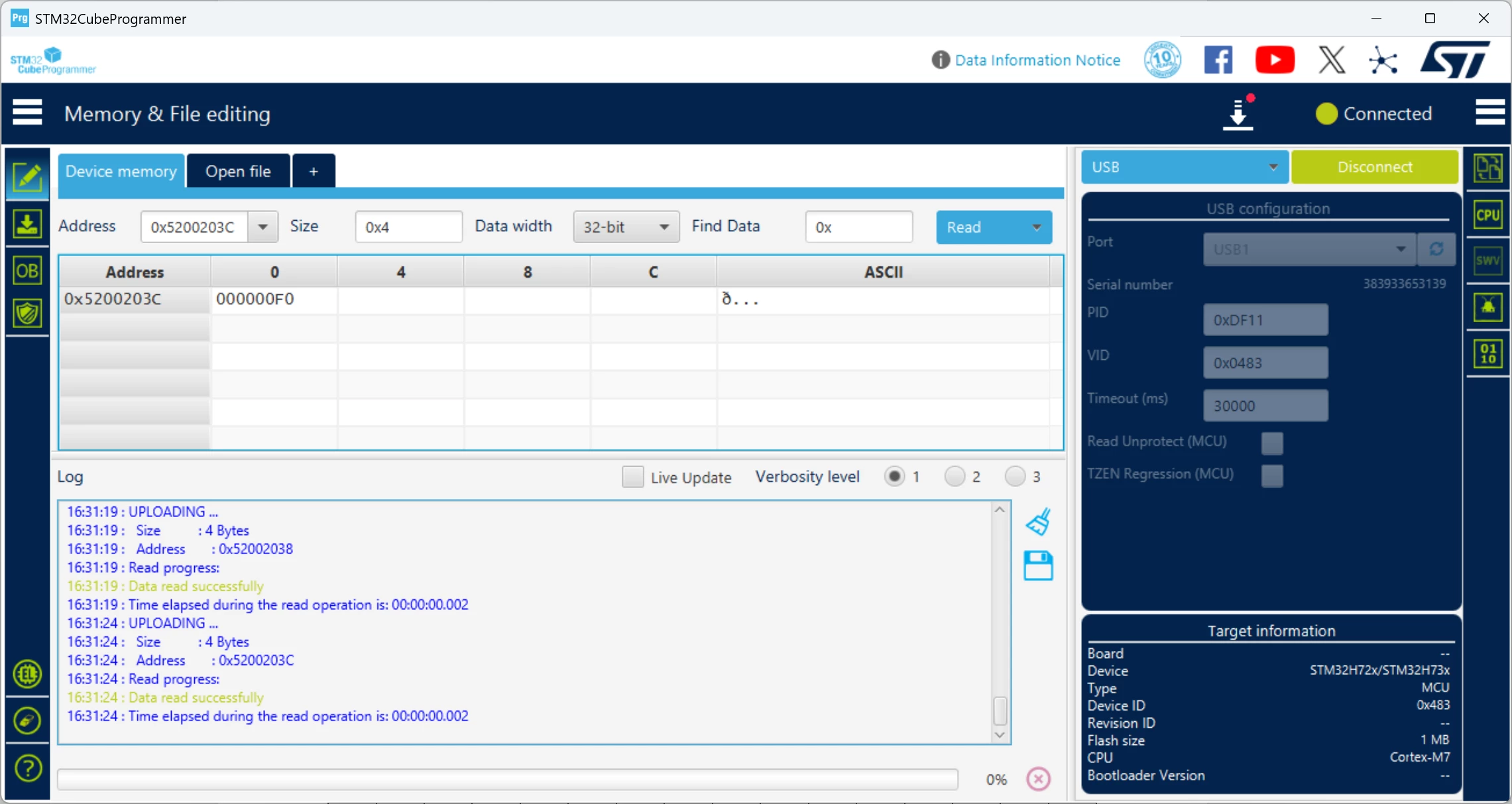

Brother, you are making this harder for those helping with all the unnecessary talking down and snark.
The actual bytes in the commands to send are outlined in AN3156. Typically, you are not interfacing with the bootloader at the byte level in DFU so these are not helpful. How you send them depends on what software you are using to interface with USB DFU. What software are you using? In STM32CubeProgrammer, you would change the address to show option bytes, edit one, and press enter.
Here’s it being done on the STM32H7. Hold BOOT0, connect over USB DFU. Same plan for the G0x1, likely different addresses.
You can see the WRP value is 0xF0. Change it to 0xFF, hit enter. Value has changed.
Power cycle it. Value has still changed. All through USB DFU interface. All through supported commands.
Can also be done with the CLI if you want.
Why does this command not remove both: The read protection AND the write protection at the same time?
Because WRP and RDP are different and RDP unprotect was not designed to modify WRP.
Why does STM implement nothing that allows to remove a write protection ?
They do, as shown in the screenshot.
