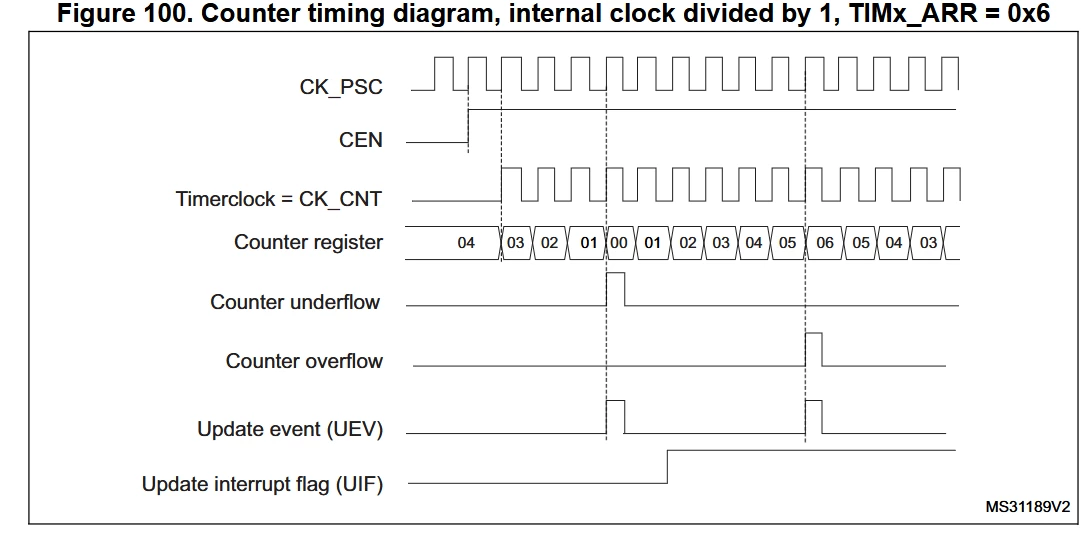

Here the UIF waveform shifted to high when counter register equaled to 0x02. Isn’t it supposed to shift at the moment the UEV is set? Figure148 also has this problem. And I traced back to the earlier versions. As far as I can reach, the figures were good until rev11, and they were changed since rev17 or earlier.

It seems the UIF is updated when counter register is 02. So UIF maybe configurable when counter register setting value

Sorry, I don’t get it. According to the manual, the UIF can only shift from 0 to 1 when one of these things happen: 1. counter overflow; 2. counter underflow; 3. an update event. But the figure I posted doesn’t match any of these cases.

I reported this behavior internally and I will get back to you for more furthermore detail as soon as possible.
Internal ticket number CDM0066642 (This is an internal tracking number and is not accessible or usable by customers).

It is a typo in Figures 100 and 148, the UIF waveform should be high at the same moment the UEV is set.
