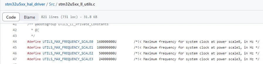

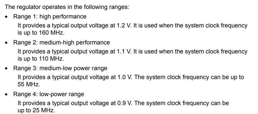

I've noticed that the frequencies written in the reference manual are different from the ones used in the HAL.
Is there a good reason they are different? Which ones are correct?
I attached a screenshot from page 407 of the reference manual.
https://www.st.com/resource/en/reference_manual/rm0456-stm32u5-series-armbased-32bit-mcus-stmicroelectronics.pdf
And a screenshot from github stm32u5 HAL stm32u5xx_ll_utils.c

Hello @GG.2 ,
The RM0456 is correct.
I confirm the issue for stm32u5xx_ll_utils.c driver and I reported internally.
Internal ticket number: 161875 (This is an internal tracking number and is not accessible or usable by customers).
Sorry for any inconvenience and thank you for your contribution in STCommunity :).

Hello @GG.2 ,
The issue is fixed in STM32CubeU5 V1.5.0.
Thank you for your contribution in STCommunity.
