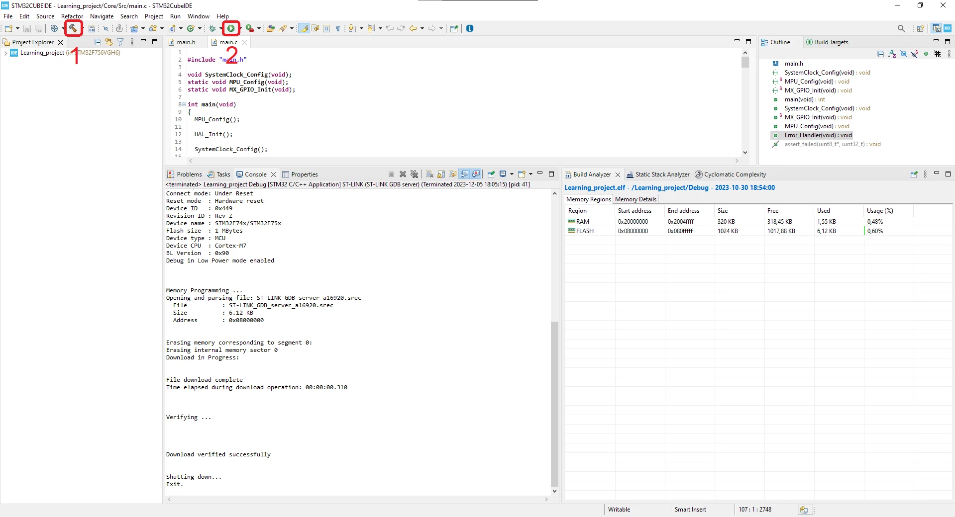

Misleading MCU flash and led blink error
I am doing my absolute baby steps in the STM32 environment. My MCU model is STM32F756VGH6. After days of debugging I finally managed to connect my STLINK V3 to the MCU but not run the led blinky :(
This TFBGA100 package on a custom breakout board might not be the best for learning. However, the STLINK can read the core ID and connect to the MCU, so I suspect my wiring is right, I have enough decoupling capacitors, USB, BOOT, NRST and other crucial pins are at their needs as well..
#include "main.h"
static void MPU_Config(void);
int main(void)
 MPU_Config();
 HAL_Init();
 SystemClock_Config();
 MX_GPIO_Init();
 while (1)
	 HAL_GPIO_WritePin(GPIOC, GPIO_PIN_14, 1);
	 HAL_Delay(1000);
	 HAL_GPIO_WritePin(GPIOC, GPIO_PIN_14, 0);
	 HAL_Delay(1000);
void SystemClock_Config(void)
 __HAL_RCC_PWR_CLK_ENABLE();

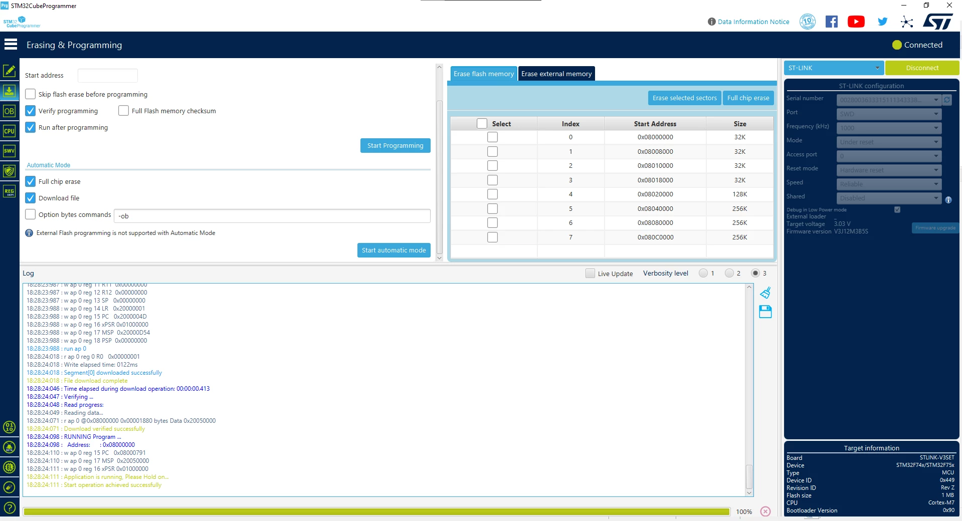

This simple program was generated by the STM32CubeIDE to flash an led on pin PC14. As I mentioned, I do not get any voltage toggling on the pin... And there is one very strange circumstance: accidentally I noticed, that I was able to flash the MCU with NRST pin unconnected  to the STLINK (NRST was floating). I tried to flash both directly from the STM32CUBEIDE and from STM32Cube Programmer, here are the logs:
STM32Cube Programmer:
18:02:56:184 : Memory Programming ...
18:02:56:184 : Opening and parsing file: Learning_project.elf
18:02:56:188 : File : Learning_project.elf
18:02:56:188 : Size : 6.12 KB
18:02:56:188 : Address : 0x08000000
18:02:56:189 : Erasing Segment <0> Address <0x08000000> Size <6268>Bytes
18:02:56:189 : Erasing memory corresponding to segment 0:
18:02:56:189 : Memory Erase via FlashLoader!
18:02:56:189 : Memory erase...
18:02:56:192 : halt ap 0
18:02:56:192 : w ap 0 reg 15 PC (0x20000000)
18:02:56:192 : w ap 0 reg 17 MSP (0x20000500)
18:02:56:193 : w ap 0 reg 16 xPSR (0x01000000)
18:02:56:195 : w ap 0 @0x20000D80 : 0x00000200 bytes, Data 0x00000000...
18:02:56:195 : w ap 0 @0x20000000 : 0x00000004 bytes, Data 0x0000BE00...
18:02:56:203 : w ap 0 @0x20000004 : 0x00000954 bytes, Data 0xF000B580...
18:02:56:203 : Erasing internal memory sector 0
18:02:56:203 : Init flashloader...

18:02:56:497 : Segment[0] downloaded successfully
18:02:56:497 : File download complete
18:02:56:514 : Time elapsed during download operation: 00:00:00.288
18:02:56:516 : Verifying ...
18:02:56:517 : Read progress:
18:02:56:518 : Reading data...
18:02:56:532 : r ap 0 @0x08000000 0x00001880 bytes Data 0x20050000
18:02:56:532 : Download verified successfully
18:02:56:562 : RUNNING Program ...
18:02:56:562 : Address: : 0x08000000
18:02:56:571 : w ap 0 reg 15 PC 0x08000791
18:02:56:572 : w ap 0 reg 17 MSP 0x20050000
18:02:56:572 : w ap 0 reg 16 xPSR 0x01000000
18:02:56:572 : Application is running, Please Hold on...
18:02:56:572 : Start operation achieved successfully
STM32CubeIDE:
STMicroelectronics ST-LINK GDB server. Version 7.3.0
Copyright (c) 2023, STMicroelectronics. All rights reserved.
Starting server with the following options:
Persistent Mode : Disabled
Logging Level : 1
Listen Port Number : 61234
Status Refresh Delay : 15s
Verbose Mode : Disabled
SWD Debug : Enabled
InitWhile : Enabled
Waiting for debugger connection...
Debugger connected
Debugger connected
STM32CubeProgrammer v2.13.0
Log output file: C:\Users\Vilius\AppData\Local\Temp\STM32CubeProgrammer_a16920.log
ST-LINK SN : 002800363331511134333834
ST-LINK FW : V3J12M3B5S1
Board : STLINK-V3SET
Voltage : 3.20V
SWD freq : 8000 KHz
Connect mode: Under Reset
Reset mode : Hardware reset
Device ID : 0x449
Revision ID : Rev Z
Device name : STM32F74x/STM32F75x
Flash size : 1 MBytes
Device type : MCU
Device CPU : Cortex-M7
BL Version : 0x90
Debug in Low Power mode enabled
Opening and parsing file: ST-LINK_GDB_server_a16920.srec
File : ST-LINK_GDB_server_a16920.srec
Download in Progress:
Time elapsed during download operation: 00:00:00.310
Verifying ...
Shutting down...
Exit.
In both cases logs seem to be indicating successful flash event, but result is the same, no voltage level toggling on on PC14 pin (I checked all 100 of the MCU pins, just to be sure that I did not mess up the numbering, no voltage toggling was detected on any of those...)
As this is my very first program, please excuse and mention even the most obvious things that are usually done working with STM32s. Maybe there is some hidden project option, maybe there is some specific reset procedure etc. Basically, anything that could prevent the MCU from working, as the code is so simple, thats its unlikely to be causing the fault. Thank you in advance
