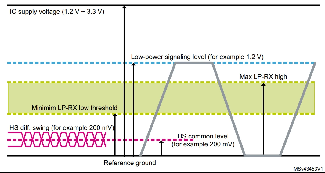

I have an issue on MIPI Display with our custom board, information as below,
  • Core: STM32U599NJH6
  • Frame Buffer Address: 0x200D0000 (Internal SRAM)
  • MIPI Driver : ST7797
  • Resolution: 400*400
Reference example : STM32Cube_FW_U5_V1.6.0\ STM32U5x9J-DK\ DSI_VideoMode_SingleBuffer
I have noticed  that example code is the same MIPI command and also LTDC timing as mine.
And I set as the same ,but still not display anything. So I checked few things,
  1.  DSI_Dn/Dp signal in scope are the same polarity (It should be differential signal)
    > PCB layout & Schematic both design in correct. And Dn/Dp is in correct impedance.
    > There is a saying, no display or Black  will show the same polarity, is it correct?
  2. In example code, there are two different CMD(SetPanelConfig, mipi_config).
    > After set with mipi_config, there is no change on display and same polarity.
    > After set with SetPanelConfig, display appear stripe but same polarity.
If it is correct of my understanding, LP mode is for CMD configuration on level ~1.2V, HS mode is in data transfer for display on level ~200mV.
But as my measure, either same polarity or always on level 1.2V.
Is there anything I missed?
Any help will be appreciate~
Thanks.

debugging
Lead
Jun 10, 2025 8:13 AM UTC
Since you did not mention the panel model hard to guess. Some LCD's need specific I2C commands to get them working and it's often not documented. Perhaps contact the supplier/manufacturer ?
