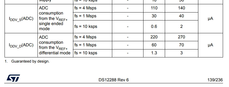

Hi ST Community,
I'm using an external precision voltage reference connected to the VREF+ pin of the STM32G474.
I would like to know:
  • What is the minimum output current capability required for the external VREF source?
  • Is there any specification for the average or peak current drawn from the VREF+ pin during ADC conversions?
  • Does the required current depend on the ADC sampling rate, the number of ADCs operating simultaneously, or the sampling time?
  • I couldn't find a clear specification for the VREF+ input current in the datasheet or reference manual.
Any explanation or recommendation would be greatly appreciated.
Thank you!

Does this answer your question?
https://www.st.com/resource/en/datasheet/stm32g474re.pdf#page=139
via: https://www.st.com/en/microcontrollers-microprocessors/stm32g474re.html

Q:
Since architecture is SAR, and there are no pre-charge buffers on signal inputs and on reference inputs, than rough approximation is that I-ref = I-inputs. And I-inputs = V / R, where R = 1/ 2*PI()*Freq*C, C - sampling and hold, Freq - sampling rate. Sure, multiply by N if more than 1 ADC operating.
