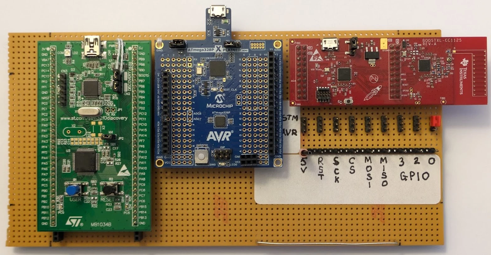

Here, I'm porting from an AVR to an STM32; so two completely different architectures - not even the same family or same manufacturer!
