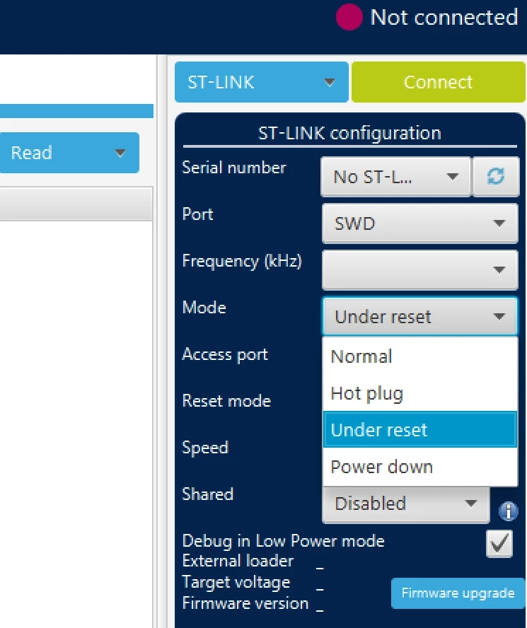

STM32Programmer (current version) has three Reset mode options - “Software”, “Hardware”, “Core”. I do not have option of “Connect Under Reset”. Is “Connect Under Reset” implied by one of three Reset mode options in software?

Pulled directly to 3,3V is incorrect , hope you use pull up resistor. And programmer for STM have MODE for connection and next setup for systematic resets many years…

And important : your “STLINK V2”   is genuine or the stick ? Because the st-link sticks have no working hardware reset !
Only possible then :
  • connect (rst pulled hi) in dfu mode to UART , using a RS232/TTL - USB adapter
  • pull rst low and try to connect st-link in CubeProgrammer mode >under reset< + >hardware reset<
