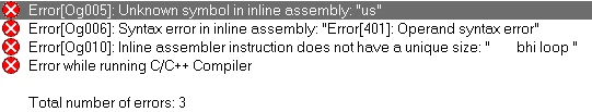

I needprecise microseconds delay routine in myapplication ( uses STM32F103RE)
I saw
https://github.com/leaflabs/libmaple/blob/master/libmaple/include/libmaple/delay.h
for microseconds delay routine. It has the following:
static
inline
void
delay_us(uint32 us) {
us *= STM32_DELAY_US_MULT;
/* fudge for function call overhead */
us--;
asm
volatile
'' mov r0, %[us] \n\t''
''1: subs r0, #1 \n\t''
'' bhi 1b \n\t''
: [us]
''r''
(us)
''r0''
I'm trying to rewrite this routing in IAR EWARM 6.3 I would like to write the same function in IAR EWARM 6.3 I get the following error if I use the same code: Error[Og006]: Syntax error in inline assembly: ''Error[41]: Bad label''
Anyone who hasexperience in writing code using IAR embedded workbech, suggestions pleas

    static void delay_us(uint32_t us)
    us--;
    asm('' mov r0, us
    ''loop: subs r0, #1
    '' bhi loop

    Posted on December 21, 2012 at 06:42
    Sorry for the late reply.
    The following errors are shown when compiled. Do we need to activate any settings in IDE ?
    The following link may help us to resolve:
    http://supp.iar.com/Support/?note=31237&%3bfrom=search+result
    Thank you

    Don't know the IAR toolchain in detail, but C level variables usually get prepended by a '_' in the assembler/linker stage. I would try '_us' instead.
    And I'm not sure, lacking the IAR detailled knowledge, how you tell the compiler that the variable 'us' is manipulated in assembler code.

    I used IAR EWARM 6.40.3.4115, worked there. Why not just put it in startup.s in straight assembler?
