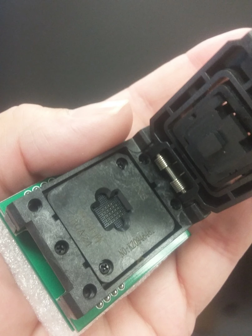

Tesla DeLorean
Guru
June 29, 2022
I ended up getting a bunch of MT35XL512ABA1G12-0SIT from the NEWARK side of AVNET, FARNELL, ELEMENT14, UKRAINIUM, et al..
NEW2022 code give 20% off, and enough to get free shipping..
