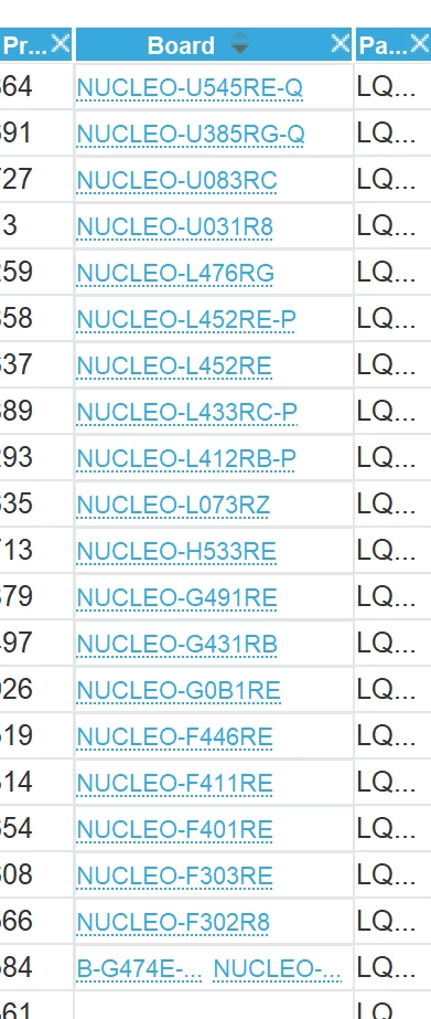

Mar 19, 2026 4:16 PM UTC
> 3 × I2C
> Compact (48 pins)
According to STM32CubeMX, there are no nucleo boards in an LQFP48 package that have 3x I2Cs.
Download STM32CubeMX and use the product selector to sort through chips and available board.
If you relax this to only 2x I2C, there are quite a few:
Any will work. The STM32U0 series is a good balance of new/simple, in my opinion
Advice: Stay far away from STM32C5 until it has good support. Stick with STM32CubeMX-compatible chips.
