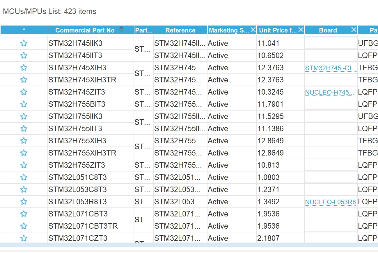

Lots of chips can do this. Use the chip selector in STM32CubeMX to narrow down the selection. Here are some of them:
A 10 MHz SPI clock is not very high--all chips with an interface should be able to do that. The temperature spec is the driving condition here.

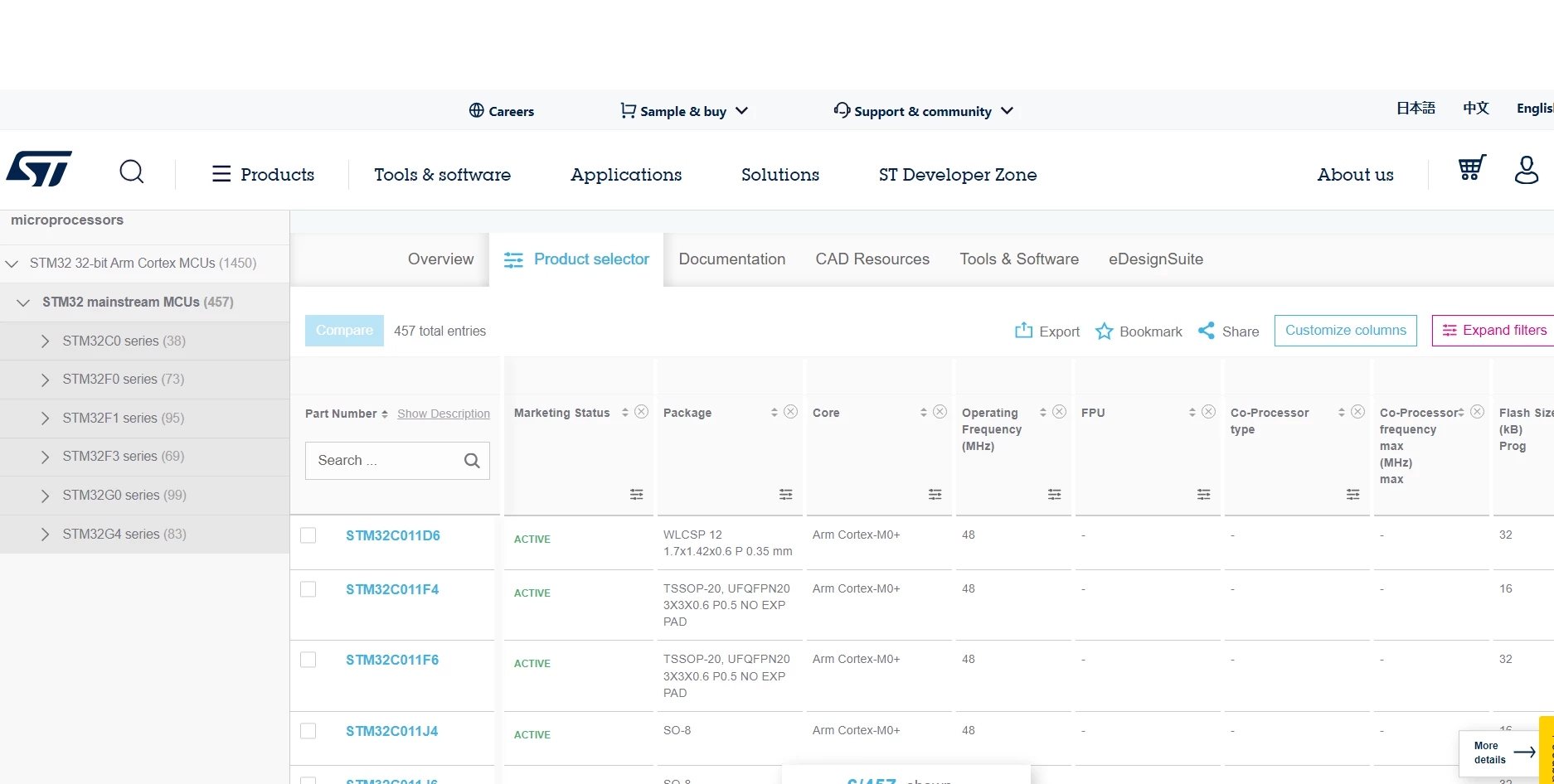

I suggest to use the online product selection on st.com (STM32 Microcontrollers (MCUs) - STMicroelectronics).

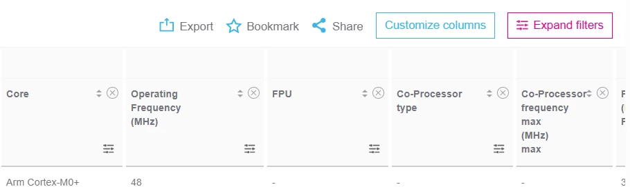

Product selector is applicable by Category. For example, below I'm searching within mainstream STM32 MCUs :
push the pink button expand filters:
Apply the filters you need: below I put the min of SPI and USART that your rquested and Min/Max Temperatures:
As a result I got 17 MCUs in mainstream. You can follow the same filtering method for other STM32 highPerf, ULP and wireless
