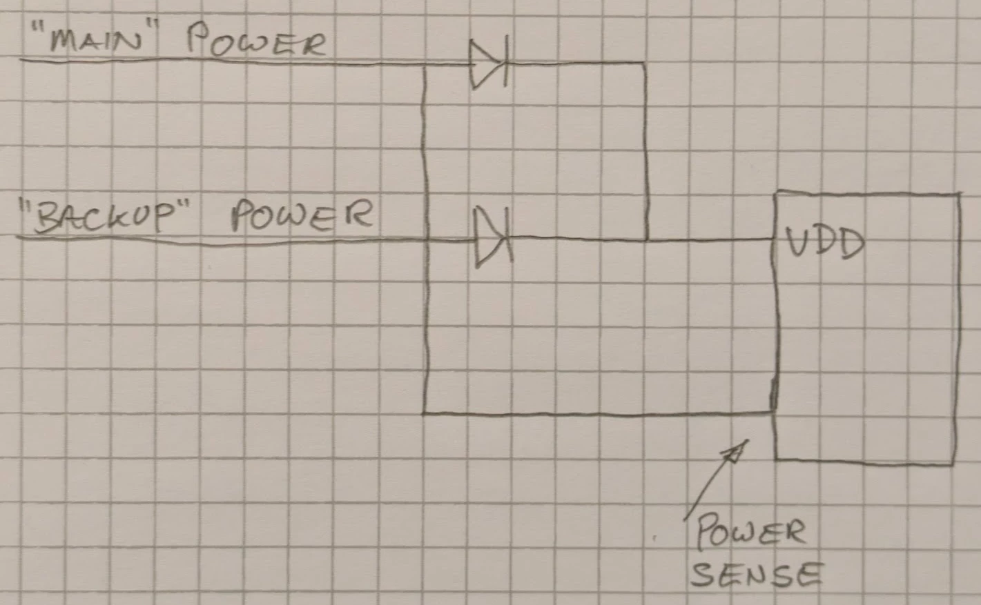

@LMore.2 wrote:
This microcontroller doesn't have a dedicated VBAT pin. From what I understand, both the main power supply and the backup battery should be connected to the single power supply pin,
Correct - as stated in @TDK's solution above
@LMore.2 wrote:
 But how does the microcontroller know which power source is supplying it,
That will depend entirely on your power supply design.
You have to design your power supply so that it can switch between "main" and "backup" power sources, and give a signal to the STM32 indicating which one is currently in use.
There are chips which can do this, or you can make a discrete design.
PS:
Here's an example
The diodes will "choose" between the Main & Backup power.
The 'Power Sense' input to the STM32 allows it to "see" when Main power is available - if the Main power is not available, it can conclude that it must be running on Backup power.
Note that this has nothing really to do with the STM32; this is general to anything that has Main & Backup power - it's a power supply design issue, rather than an STM32 issue.
"Power Path" would be a good search term ...

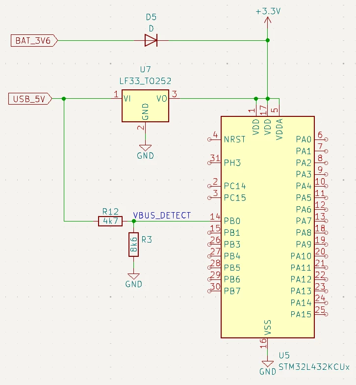

LMore.2
LMore.2Author
February 6, 2025
Hi Andrew,
something like this one?
PB0 (vbus_detect) report information when 5V is present or missing. If missing power from USB, MCU go in STANDBY, when power return MCU exit from sleep on 'PIN change'. Is it correct?. Any better schematic solution? Which chip can do this? Thanks
Andrew Neil
February 6, 2025
When the USB power is removed, that will apply battery power to the output of the U7 regulator - which may not be a good idea ...
What kind of battery is it? Does it need charging?
