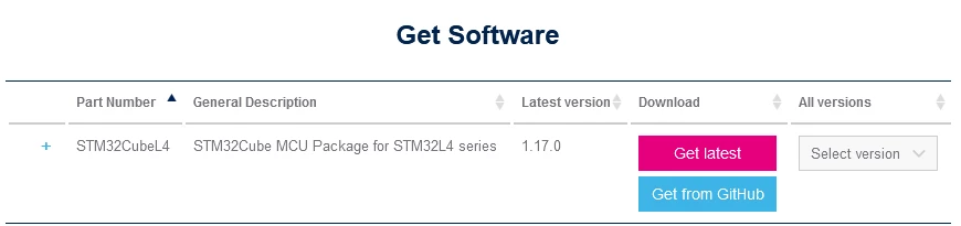

DYann.1
DYann.1Author
Senior II
November 19, 2021
DYann.1
DYann.1Author
Senior II
November 19, 2021
This one ?
mƎALLEm
November 19, 2021
Yes.
