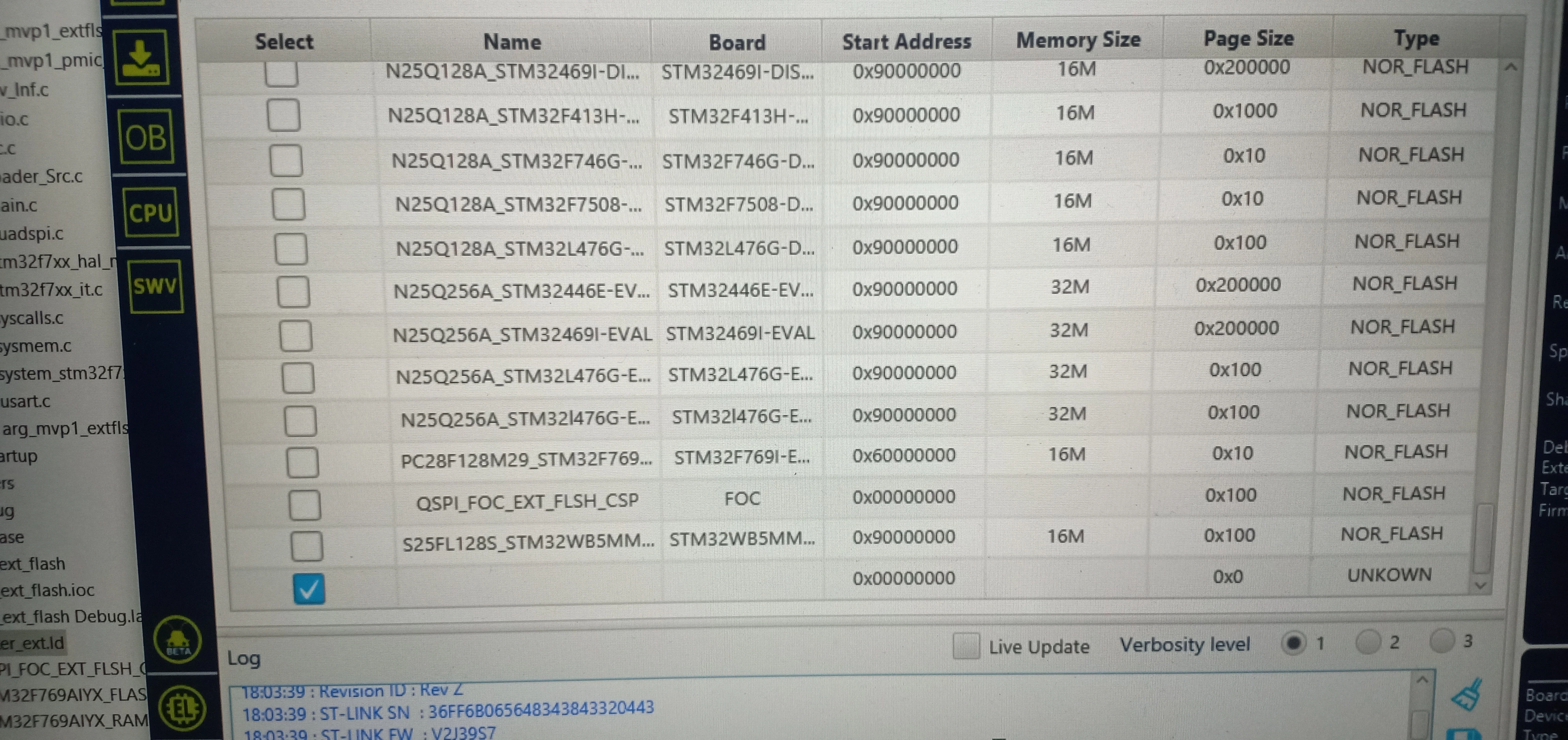

Vins
VinsAuthor
March 17, 2022
Hi @Community member​ I am working on creating STLDR means External Loader. ​ I am getting stldr as in attached image.
Tesla DeLorean
Guru
March 17, 2022
The StorageInfo structure doesn't look correct, or perhaps exported incorrectly
