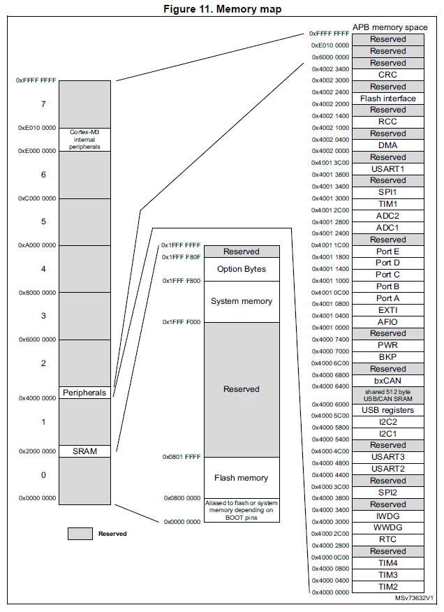

I want to know the address in the memory map, is it a virtual address or a physical address?

What do you mean by virtual/physical address? This is the MCU world (STM32F1xx) not MPU/MMU and they are physical addresses.

They are all physical - real, hardware addresses.
