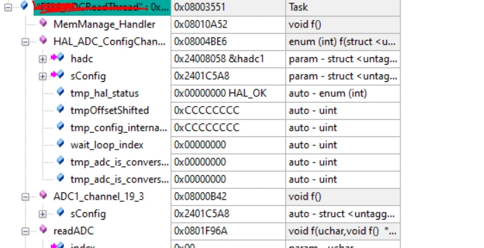

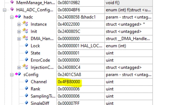

Please refer to the image above. I can now confirm that hadc1.Instance correctly points to ADC1 at address 0x40022000; however, sConfig.Channel appears to be mapped to an incorrect memory location. Any suggestions to help resolve this issue would be helpful. Thank you.

> ... however, sConfig.Channel appears to be mapped to an incorrect memory location.
I don't know what this sConfig / Channel parameter are used for, I don't use Cube/HAL in any of my projects.
But it is supposedly related to the channel setup, and most probably not the cause for the MPU fault.
I suggest to debug in single-step mode, to see which access actually triggers the MPU fault.
Or retrieve the fault address from the respective Syscfg register in the fault handler afterwards, and crosscheck with the map file.
May 27, 2025 12:06 PM UTC
Thank you for your assistance.
I am working with the STM32H733 microcontroller and handling multiple ADC channels as shown in the example below:
ADC_ChannelConfTypeDef sConfig = {0};
sConfig.Channel = ADC_CHANNEL_19;
sConfig.Rank = ADC_REGULAR_RANK_1;
sConfig.SamplingTime = ADC_SAMPLETIME_387CYCLES_5;
sConfig.SingleDiff = ADC_SINGLE_ENDED;
sConfig.OffsetNumber = ADC_OFFSET_NONE;
sConfig.Offset = 0;
sConfig.OffsetSignedSaturation = DISABLE;
if (HAL_ADC_ConfigChannel(&hadc1, &sConfig) != HAL_OK)
 Error_Handler();
The function HAL_ADC_ConfigChannel internally calls the low-level driver functions, and during this process, the line
adc1.Instance->PCSEL_RES0 |= (1UL << (__LL_ADC_CHANNEL_TO_DECIMAL_NB((uint32_t)sConfig.Channel) & 0x1FUL));
is executed, which triggers a Memory Management fault.
