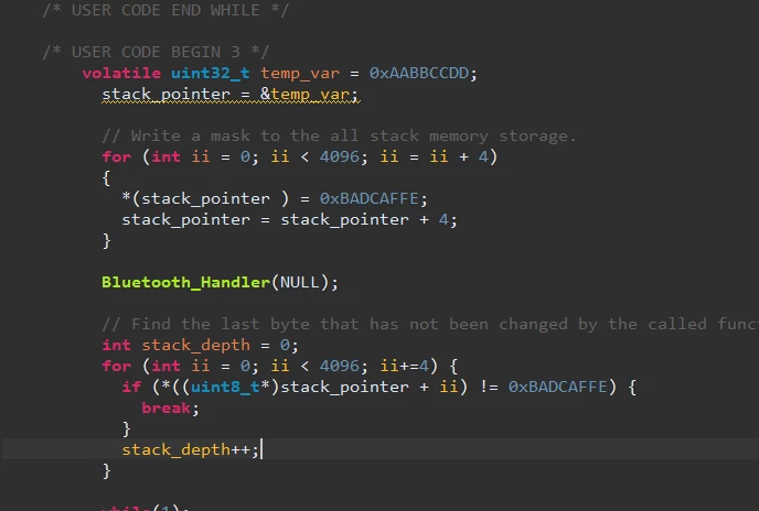

Measuring stack depth of function cause hardfault, inside the first for loop when ii > 4 the IMPRECISERR bit is set in the Configurable Fault Status Register (CFSR)

the stack goes down, not up?

> inside for loop when i > 4
which loop? which i?
What type has stack_pointer? You cast it to uint8_t in the second loop, but not in the first?
ST uses the gcc idiom
register char * stack_ptr asm("sp");
to get the stack pointer
hth

I made edit

what type? What + 4 does depends on the type (size).

unit32_t, I guess I'm increament the pointer in wrong direction

So, I have to decreament the pointer, not increamenting it
