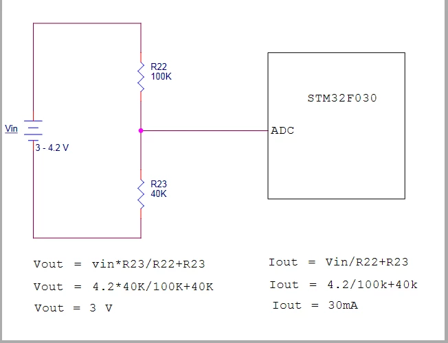

Hello Avatar and Danish.
Here i am sharing image with calculation and values of Divider with Vout and Iout.
Also attached same image.
external input impedance of ADC pin is 50k.
Does these values help in matching 50k impedance.
if i am using value of R23 below 50K than does it match external impedance????
I want to restrict current output to micro ampere can i increase R22 value to 10M ohm??
I am more confuse related to term matching impedance or equivalent impedance with both resistors.
If i am wrong in calculation than correct me.
AvaTar
Senior III
October 25, 2018
Your Iout calculation is wrong, you miss a factor of 1000. Would be 30uA, not mA.
For the ADC, only R22 would be relevant for impedance consideration. And I think 100k is already far too large to drive the ADC directly.
Ignoring internal impedance, R22 und the S&H capacitor for a RC element that needs to be charged during the sampling time. Which is not difficult to calculate.
I think you will need an opamp as impedance converter, even for R22 = 100k.
Going up to >1MOhm, you would definitely need to take opamp input leakage and bias currents into account.
HRawa
HRawaAuthor
October 25, 2018
Dear Avatar,
It means R22 should be restricted to less than 50K to match external impedance????
I dont want to add more circuit in my design.
Suggest me values of resistor R22 and R23.
AvaTar
Senior III
October 25, 2018
Your application and your requirements, you need to do it for yourself. The will be a trade-off between accuracy, battery drain, and BOM costs. I can't take responsibility for your design decisions.
Check the "Maximum ADC RAIN" table in the datasheet. For the L431xx, it is table 67 at page 140.
For 12 bit resolution, you don't get below 33k even for the longest sampling time.
