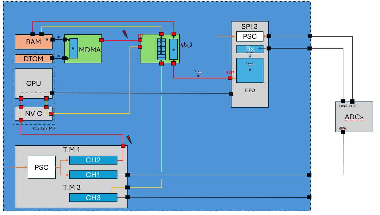

Hello and good year everyone,
I am trying to follow the architecture below, where I read 1 ADC halfword at 2KHz via SPI. The idea is to trigger the DMA 1 Channel 3 as soon a new data is available in my SPI. It transfers my data from SPI to RAM.
As soon the DMA Transfer is complete, I need the MDMA to immediately transfer the data from RAM to DTCM.
It seems like my SPI read is good, my DMA transfer from SPI to RAM is good too. However, the MDMA does not transfer any data from RAM to DTCM, do you know why ? Below are the interesting part of my code :

Any help would be much appreciated ! :)

Hi @MonsieurShann,
I'm not an expert in MDMA, but what I know is that you need to set up a DMA transfer from the ADC to RAM. Then, at the end of the transfer, trigger an MDMA transfer from RAM to DTCM-RAM. I advise you to have a look at application note AN5001. It's a good reference to consult.
Also, there are examples in STM32H7Cube under the examples directory that describe how to use MDMA with DMA.
Thank you.
