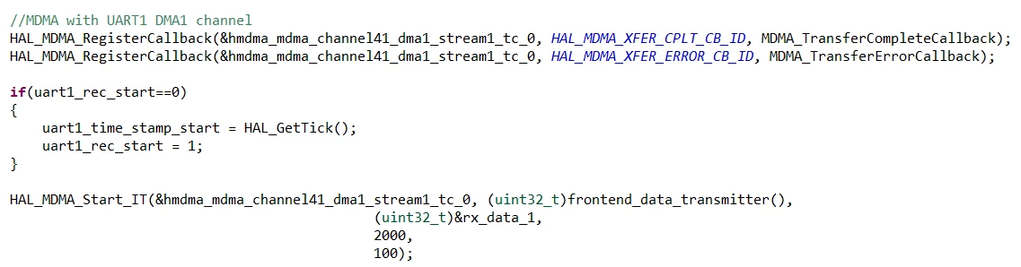

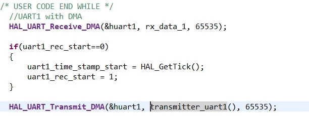

Hello ST community,
I was able to perform the loop back test using DMA by using HAL layer provided by ST microcontrollers. It worked successfully.
Next I wanted to transfer more data using MDMA and below is the code snippet. I was unsuccessful and couldn't find the reason behind it.
I generated code using STMCubeIDE and have invoked necessary API's in main.
Any leads here would be appreciated.

You are giving HAL_MDMA_Start_IT() a function (frontend_data_transmitter()) instead of a pointer to the source address, how's that supposed to work?
BTW, it's nicer for others if you paste your code as text, not as pictures.
