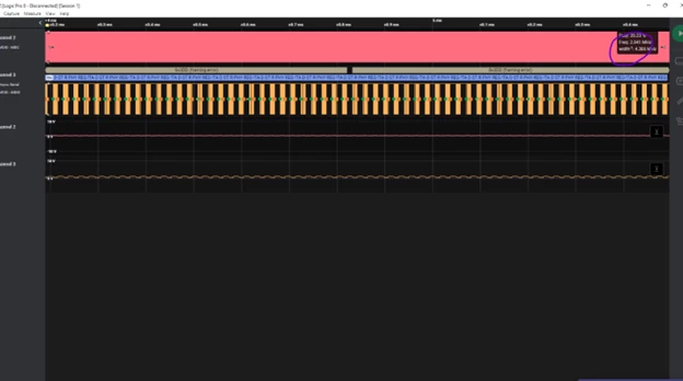

MDIO bit banging data rate Hello, We have implemented MDIO(Management Data Input/Output) protocol by bit banging in the STM32 Nucleo-L series board and the corresponding frequency of MDIO is 2.8MHz as of now.

    Thank you for replying to my team mate's question. Here is the code for MDIO write and read. The MCU we are using is STM32L552MEY6
    void OUT (unsigned long data, unsigned char p)
    unsigned char j;
      // Output a value to the management interface.
      data <<= (32 - p);
      for ( j=0; j<p; j++ )
        if (data & 0x80000000)//0x80000000=true? 1010 & 1000,0100 & 1000=0,1000 & 1000 =1,0000
          //SET_MDIO_PIN_HIGH;
          HAL_GPIO_WritePin(GPIOB,GPIO_PIN_4,1);
        else
          //SET_MDIO_PIN_LOW;
    HAL_GPIO_WritePin(GPIOB,GPIO_PIN_4,0);
    HAL_GPIO_WritePin(GPIOB,GPIO_PIN_2,1);
    HAL_GPIO_WritePin(GPIOB,GPIO_PIN_2,0);
        data <<= 1;
    void WRITE( unsigned int phy_ad, unsigned int reg_ad,unsigned int Value)// mdio write
    OUT(0xFFFFFFFF, 32);
    OUT (0x00000005, 4);
    OUT ((unsigned long)phy_ad, 5);
    OUT ((unsigned long)reg_ad, 5);
    OUT(0x02, 2); // turnaround time
    OUT(Value, 0xFDAC);// 16 bit data
    Just thinking about FPGA to do this more efficiently. Just trying to understand when to make that pivot? The board contains one MCU pinging 5 PHY chipsets and reporting data over serial protocol to a GUI.

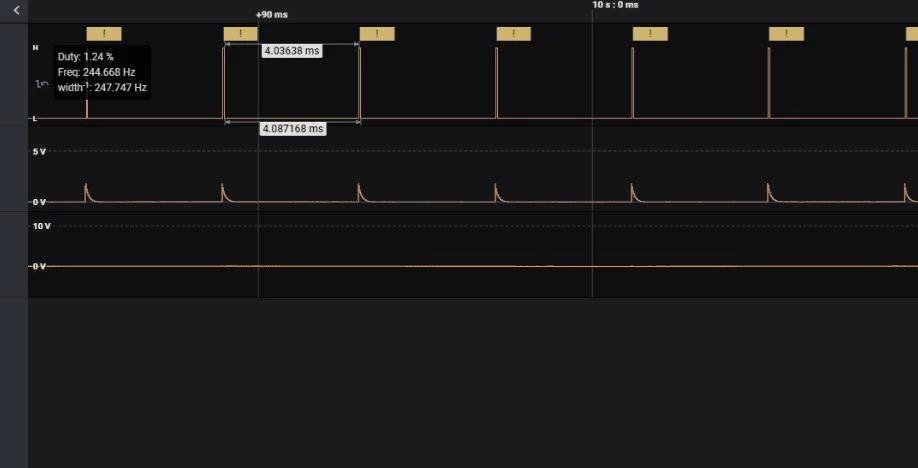

    Thanks for your reply, yes have been into looking the reference manual of our particular board and thereby "SET" the BSRR reg and got pull down frequency from 2.6Mhz to 250 Hz. I know it should increase as you said earlier (by eliminating the function call for HAL_WRITE_PIN). Kindly share your thoughts on these anomalies!
    0693W00000Y8RBiQAN.jpgCode:
    while (1)
    GPIOB->BSRR = (uint32_t) GPIO_PIN_6;
    GPIOB->BSRR = (uint32_t) GPIO_PIN_6 << 16U;
    Note: Just trying to toggle the GPIO pin 6 and then if it meets our requirements can implement the same in MDIO fun calls !!
    regards
    Sa.2
    gbm
    January 17, 2023
    Replace the body of your loop with:
    GPIOB->BSRR = data & 0x80000000 ? GPIO_PIN_4 : GPIO_PIN_4 << 16;
