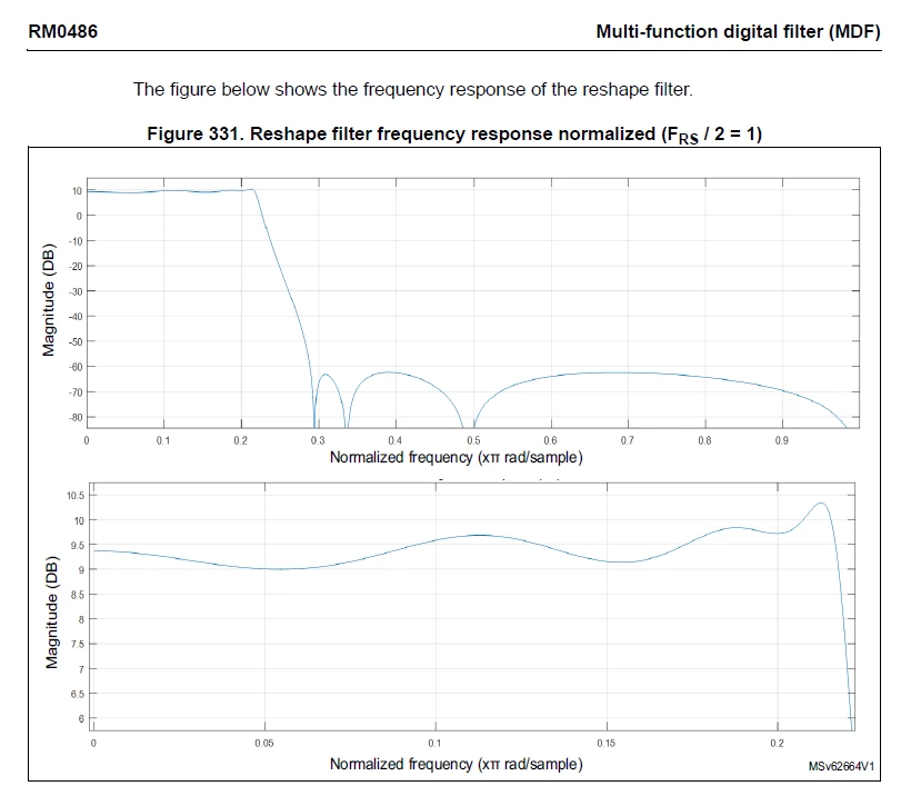

MDF reshape filter phase response
Could you please share the phase response of the Reshape Filter? The reference manual only provides the magnitude response, as shown below
Regards.

Hello @ERROR ,
Please find in attachment both phase and magnitude for MDF Reshape Filter.
Hope this answer your question.

Hello @ERROR ,
Thank you for your post.
I have raised your request for a complementary figure through an Internal Ticket ID: 219822 (Ticket number is only for reference, not available outside of ST)
We will provide you with an update as soon as possible.
Thanks for your contribution.
Imen.DBest answer
Oct 22, 2025 1:34 PM UTC
Hello @ERROR ,

Hi @Imen.D ,
Thank you indeed!
Regards.
