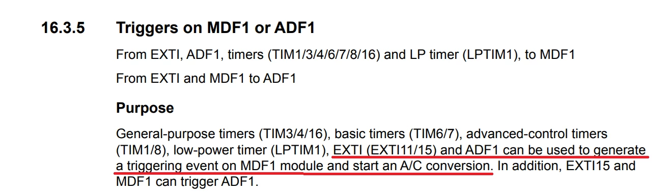

We want to trigger two conversions from the same EXTI (EXTI11).
Basically rising edge on GPIO B11 should trigger ADC12 conversion and MDF (sigmadelta)
Is it possible?

According to the documentation there is that statement:
But still to confirm if "A/C" means ADC. I will check internally and get back to you as soon as I have an answer.

Indeed A/C stands for ADC.
