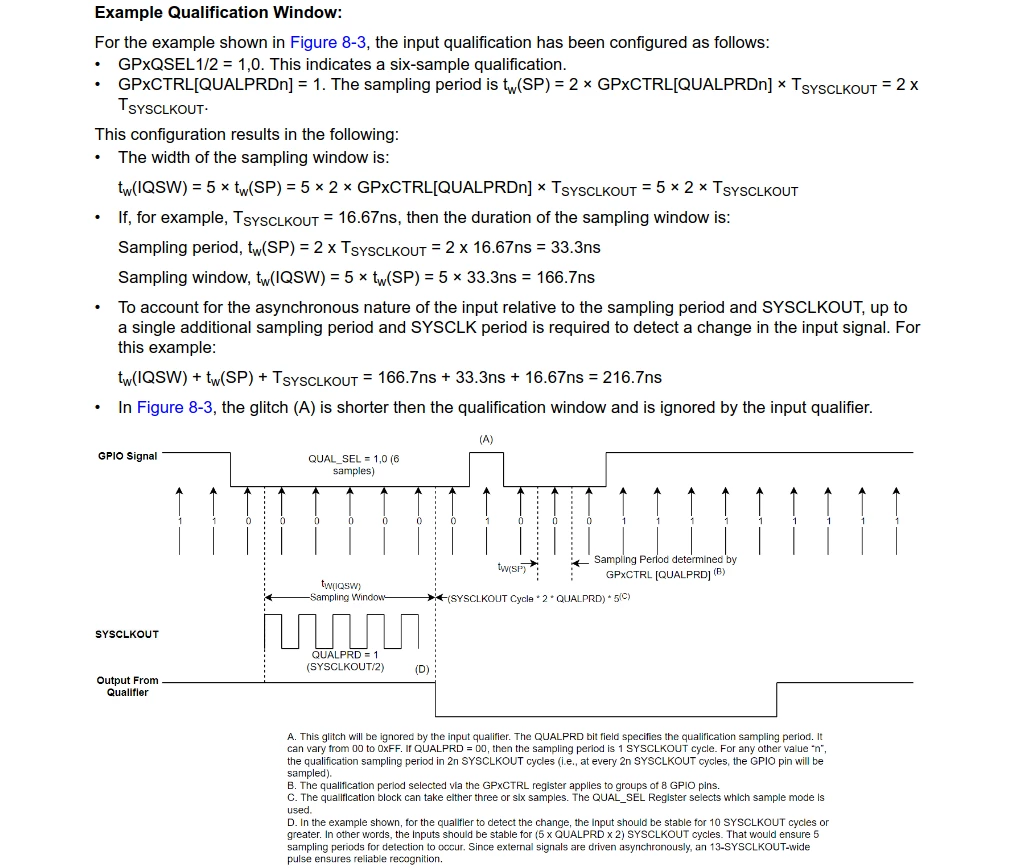

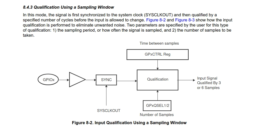

I'm trying to find out if any STM32 MCUs support hardware input qualification on GPIOs, similar to what's available on TI C2000 MCUs.
On the C2000 series, GPIOs can be configured for input qualification using a sampling window—typically 3 or 6 samples spaced apart based on the system clock. Here's a reference from the C2000 TRM for clarity (see attached images):
  • Sampling is done every 2 × QUALPRD × T_SYSCLKOUT
  • The input must be stable for multiple consecutive samples before it's considered valid
  • This helps filter out glitches or noise on input lines without software debounce

The answer to your original question is, probably not, certainly not in any STM32 before 'U5/'H5.
> EXTI digital filters (in G4/H7)
No such thing. Let me guess: you've consulted AI?
