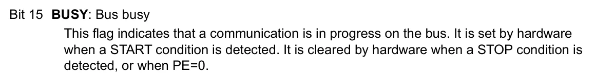

And before anyone asks: I have tried to use the MasterTransmit_IT() HAL function, but this also generates no activity on the line. I also have attempted to execute the communication attempt with the ADXL345 disconnected and the I2C pins just connected to the breadboard with the pullups - still no clock pulses, so I don't think the accelormeter is in any odd state where it it's holding the lines high. I also have seen that once the HAL Mem_Read() or MasterTransmit() functions are called, the START bit is set although I see no start condition on line. After this, the BUSY flag is stuck set in the ISR register. I also have ensured the PE bit is set in CR1.

Is BUSY is set, it indicates that the lines are low, likely due to a START condition.
