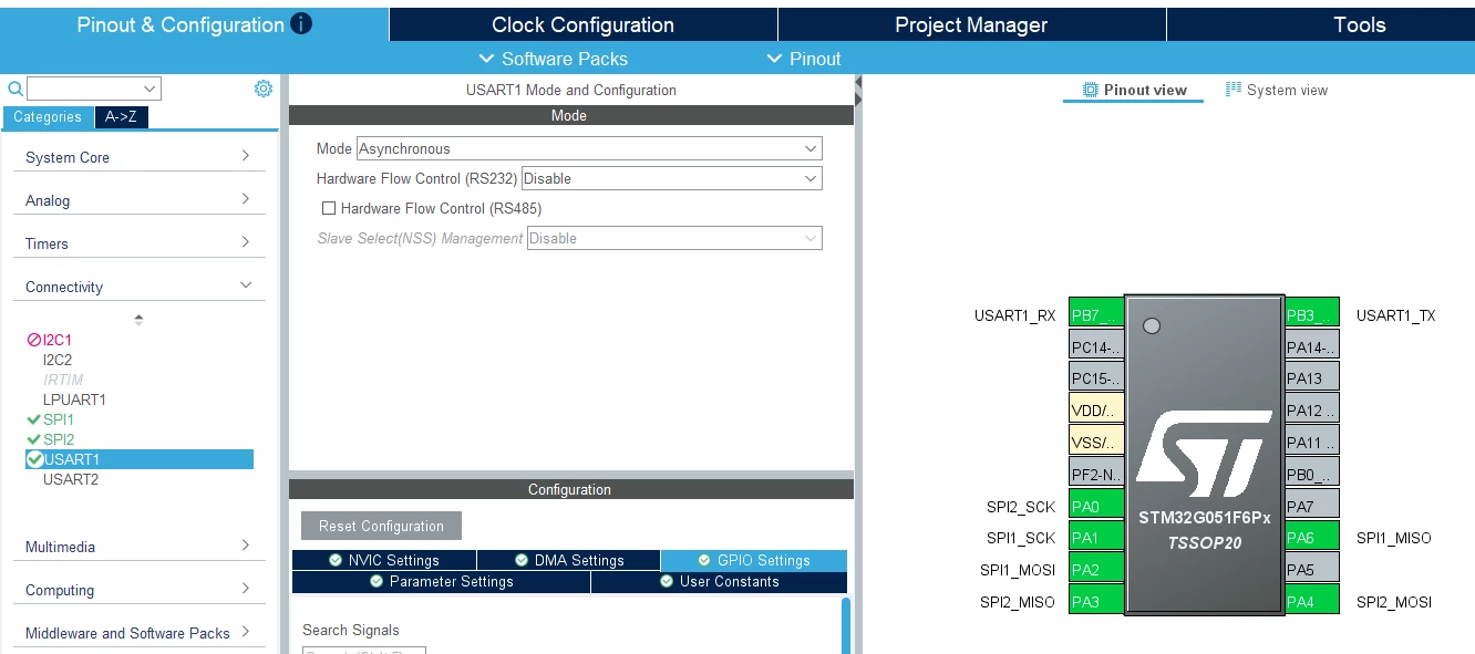

mƎALLEm

I did the exercise with CubeMx / STM32G051 TSSOP-20 and indeed you can use Two SPIs + one UART at the same time.
