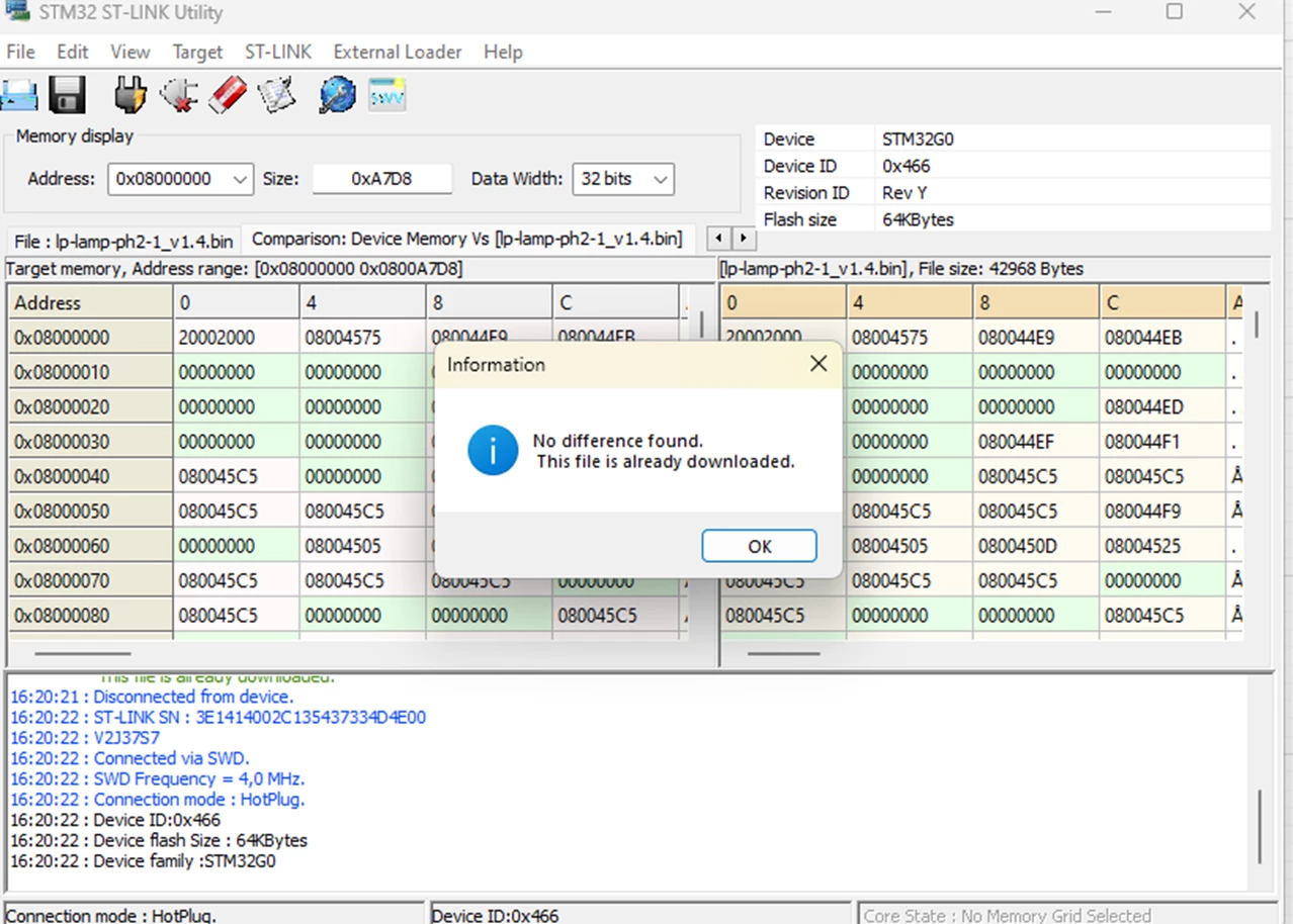

    • After removing power to the MCU and the rest of the circuitry completely and re-applying the power again, the MCU remains frozen at this step.
    • We also checked for flash corruption. When we read the Flash (Device memory) and save the file and compare the saved file with the original binary, there are no differences. So, this proves that there is no corruption in flash.
    • We cannot reproduce this issue at our place, but the customer reproduces after 5 or more iterations of battery charge and discharge cycles.
    • Also, this issue is not reproducible on every device. Approximately 10 percent of the devices.
    • When we reflash the MCU, then the problem strangely goes away.

Visitor II
May 17, 2024
This is the screenshot of the ST-Link utility after comparing the faulty PCB flash memory:

Quoting from the initial post:
These appear to contradict: the customer appears to complain about consequences of "battery charge and discharge", whereas you appear to have tested "removing and re-applying power" but that failed to reproduce the issue. Is this correct?
Have you, at your place, tried battery charge/discharge cycles; or something mimicking this process like a power supply being slowly brought down and then up again?
If not, and if what I wrote above is true, then, as @MM..1 said above, this much like sounds like brownout problem. Then the questions are:
- how are BOR options set?
- couldn't the observed behaviour be consequence of VBAT brownout?
You definitively should try to reproduce the problem at your place, first; and then observe, what does the "frozen" code do.
PS. @David Littell : I see your point and generally subscribe to it, but the pulldown on BOOT0 may be not absolutely necessary if the options are consistently set to ignore that pin, would you agree?
