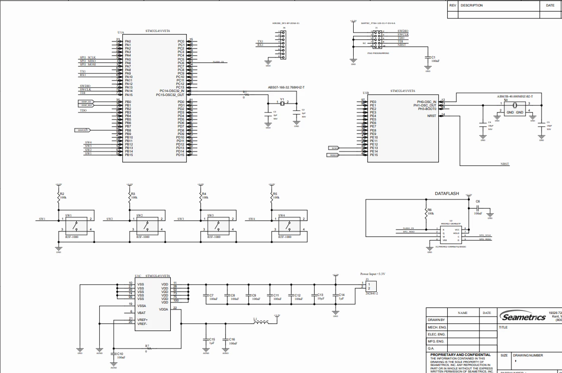

I have a simple demo board with a STM32L451VET6, a SPI LCD and four switches. The board will send the first byte over SPI perfectly, then either during or right after sending the second byte - it appears the MCU shuts down - as the CS line drifts down to 0v and single stepping in the code it just stops stepping - no errors - no faults.
This is a minimal program with just two lines added to the auto-generated code.
Any Ideas ?

Likely to be a hardware issue. Probe the NRST line, probably gets pulled low and holds the chip in reset. Look at power rails and ensure sufficient current capacity. Ensure power to chip is valid.
If you can show the schematic, please do.

Here is the schematic - and attached also.
I believe you are right about it being HW. I started a new project with just one GPIO pin toggling. It works when single stepping but if I let it run it runs for about a second and stops. I did find I had a couple 3.3V pins not connected and AGND was not connected to GND - fixed those thinking that was the trouble... but its still stopping. And I have tested on two boards - same bad behavior....

Schematic looks fine.
That was the trouble. Doesn't mean there aren't more issues. Check all connections to VDD and VSS. Show high resolution photos of the relevant solder joints.
Again, monitor 3.3V rail to see if it drops.

Resolved!  BOOT0 was left unconnected. Set it as input and tied to GND and everything is workin ggreat!
Thanks!
