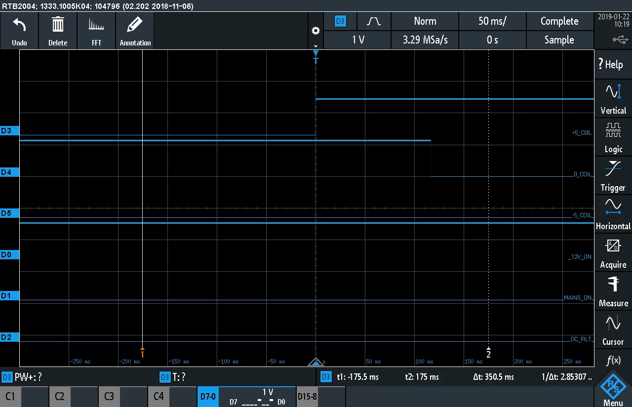

Hey guys,
I have expereinced a very strange behaviour of my STM32F429ZIT6 custom board:
When I execute the following code the processor behaves differently in free running then in manual stepped mode or my oscilloscope seems to be completely broken - which I doubt.
			_5_PLUS_COIL_HIGH;
			delay_TIM10(50);
			STANDARD_COIL_LOW;
			_5_MINUS_COIL_LOW;
the macros behinde _5_PLUS_COIL_HIGH , STANDARD_COIL_LOW and _5_MINUS_COIL_LOW are simply GPIO output state settings:
#define STANDARD_COIL_HIGH										STANDARD_COIL_GPIO_Port->BSRR = STANDARD_COIL_Pin
#define STANDARD_COIL_LOW										STANDARD_COIL_GPIO_Port->BSRR = (STANDARD_COIL_Pin	<< 16U)
#define _5_PLUS_COIL_HIGH										_5_PLUS_COIL_GPIO_Port->BSRR = _5_PLUS_COIL_Pin
#define _5_PLUS_COIL_LOW										_5_PLUS_COIL_GPIO_Port->BSRR = (_5_PLUS_COIL_Pin << 16U)

I halt the program per breakpoint at _5_PLUS_COIL_HIGH and trigger my oscilloscope on that pin to check for a rising edge, as the pin is LOW prior. Normally I would just hit run and the socilloscope would get triggered. But for a reason I don't know, the oscilloscope gets not triggered. When I maually step from the breakpoint the oscilloscope gets triggered.
Has anybody a clue why this is the case?
My processor runs only at 68MHz.

I have now checked the program run with a different oscilloscope and the errors are the same. After I have replaced the delay_TIM10(50) function with a while(!HAL_GPIO_ReadPin(_5_PLUS_COIL_GPIO_Port, _5_PLUS_COIL_Pin)); the oscilloscope's diagram looks correct except of the timings: 0690X000006DBZOQA4.png
Approx. 117ms between just two simple register writes seems an awful lot to me. But in manual stepping this program code get's not interrupted by something else.
What Do you guys think could take so long? The HAL function?? I doubt that. The HAL routine looks clean and fast to me.
Benjamin Brammer
Senior II
Jan 22, 2019 10:05 AM UTC
I think I found the error: My delay function seems not to work properly. I tried to put a 500ms delay with delay_TIM10(500). I get an approx. 175ms delay.
I put the defines here again. Maybe I have still done something wrong. Btw my prescaler value is 64000 as for 1ms tick with a APB1/2 timer clock of 64MHz.
