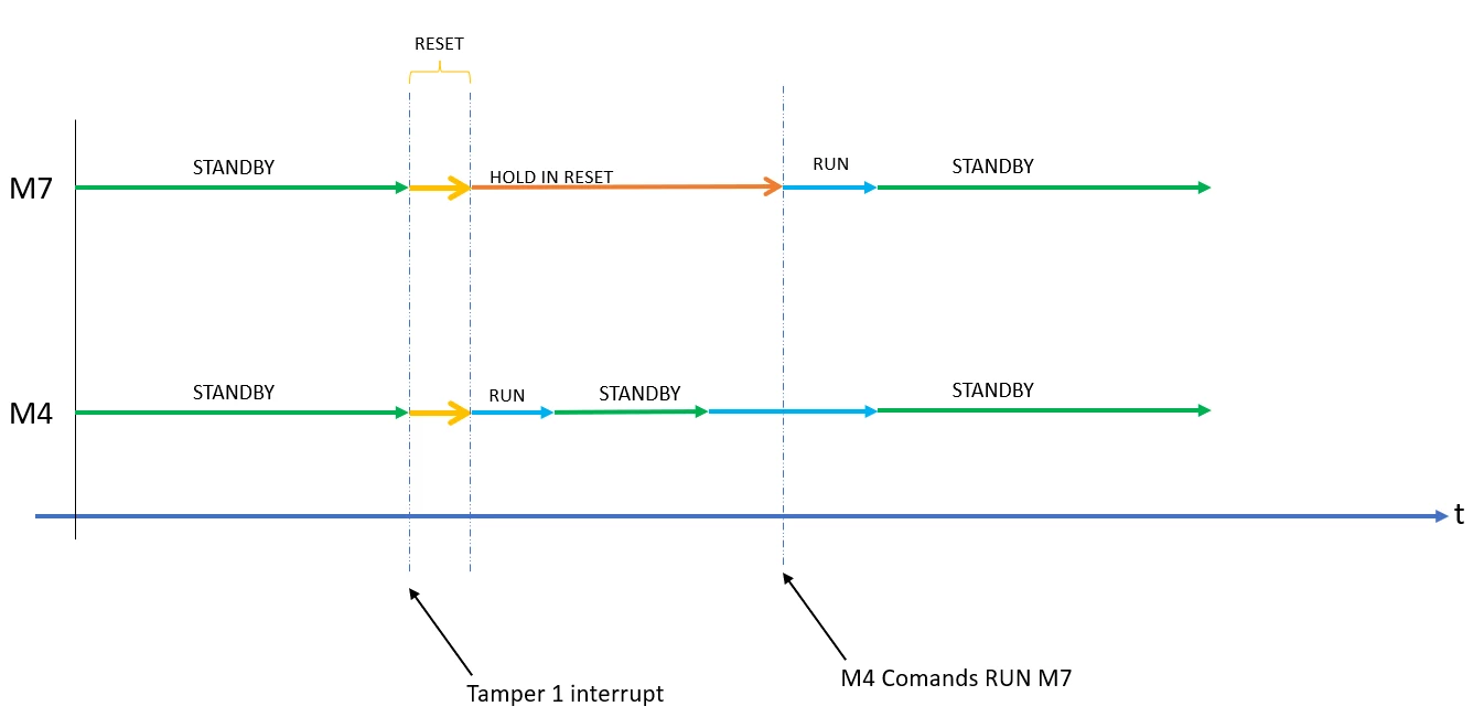

Hello again @F.Belaid​
I am working in this solution, but when we reset the system with tamper, the M7 restart too even if we don´t enable the flag BOOT_C1.
I made this behaviour timeline to help us. I need M7 to hold in reset when i use the tamper button, while M4 made the tamper callback, and then if I want re-boot the M7 app use HAL_RCCEx_EnalbeBootCore();
But when I made test, even not using this funtion the system reboot.
Thanks you
Regards!
